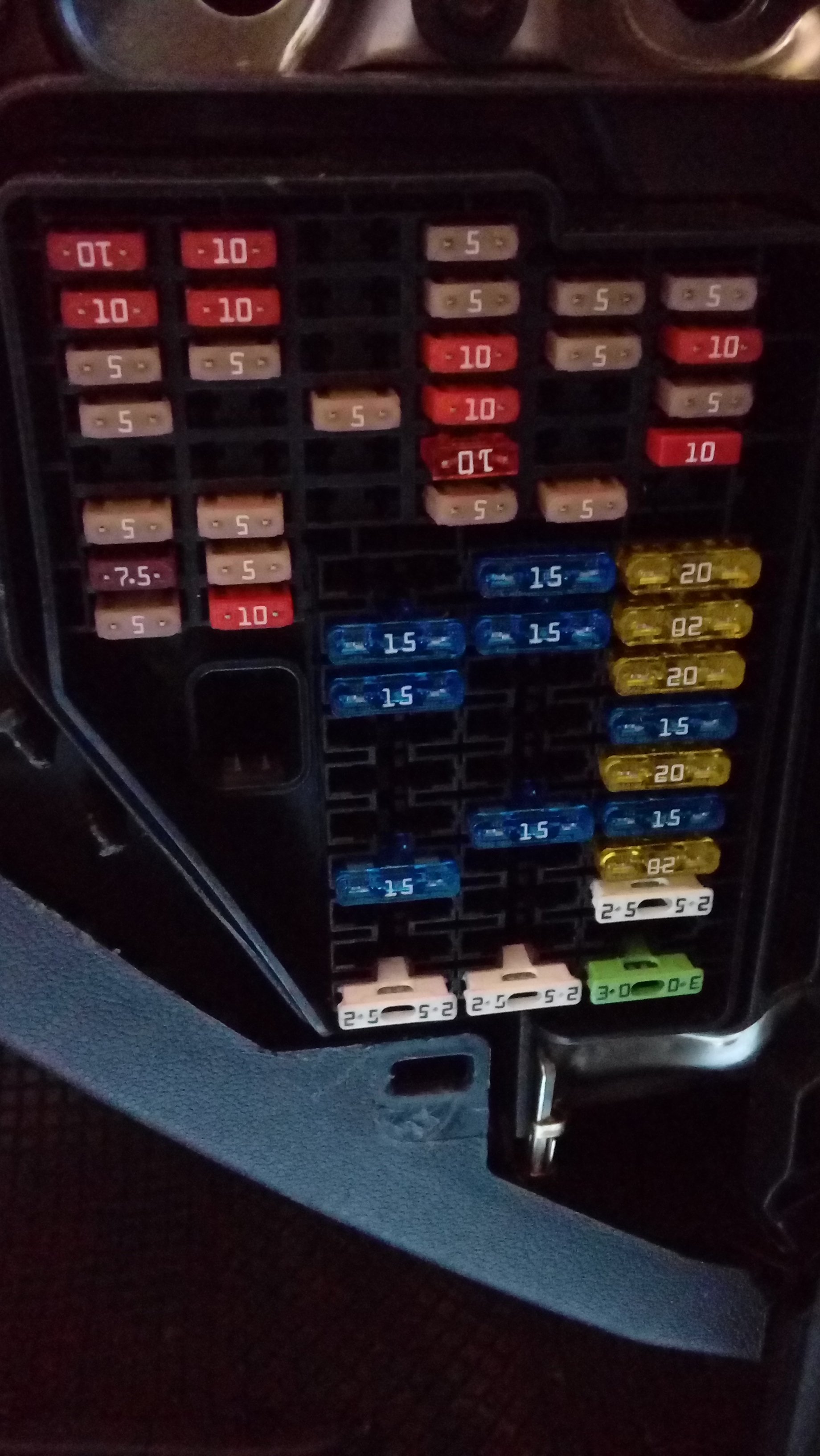

Whilst changing today I checked the battery drain using 10A and COM on multimeter bridging negative side of battery (multimeter in series). Once the current settled down it remained at 0.14A (140mA). This is too high.
I started checking/ pulling fuses found on drivers side of dash. Anyone doing this make sure you disconnect multimeter each time you open drivers door or the load on multimeter might blow its fuse or cause a fire.
Fuse 4 (interior light) was responsible for 0.02A. Probably due to Philips LED interior lights fitted.
Fuse 45 (Radio) resulted in a total drop to 0.00A (The interior lights don't come on when battery reconnected, don't know what happened to the extra 0.02A?)
What can I do about this Radio drain?
I thought I had left radio on, but it was off. Switching radio on through open window resulted in 0.67A drain. Entering radio code and switching off radio returned battery drain to 0.14A.
Is this normal for a Fabia1 07 vrs?
I left the car with multimeter connected for 10mins and it still read 0.14A so not the computer remaining awake etc.
Car has no modifications to electrics.
I wondered if locking the car might lower this drain, but I didn't want to risk blowing my multimeter with a sudden loading.
I guess I could buy a clamp type meter without risk to equipment.
Whilst checking fuses I found a couple of anomalies. One fuse for interior lighting was 15A but handbook and online states 10A. I have replaced it with 10A. The original fuse typeface looked different to all others in the fusebox.
Another fuse  37 (rear fog light and indicator) is overated at 7.5A. Handbook states 5A.
It appears original.
Shall I downgrade this one?
What shall I do about the radio? Common issue?

From my experience of chasing an excessive battery drain while the controller were asleep, on a late 2009 SEAT Ibiza 1.4, it did not make any difference if the car was locked or not.  Is the radio a genuine Skoda one, ie like what would have been fitted at the factory?
I've found that some fuse values were changed in some of my VW Group cars when compared with the owners handbook listing, only reason to drop a fuse value back down would be to protect the wiring , if you think that the present value could compromise the safety of the car then yes change them if not I would not bother.
Edit:- while that drain is higher than spec or is desirable, with a battery that was in good health and regular use of that car, this problem might not have been a show stopper.

Fuse 10 is the 's' contact fuse, live whenever key is in the ignition switch. That probably caused the radio to wake up internally, even though off.  This may have persisted for long enough to cause the situation you're seeing.

I said fuse 10 but only a guess + / - 5 fuses so fuse 5 to 15.
The fuses were pulled one at a time, battery reconnected via multimeter and current reading measured after 1min then battery disconnect and fuse replaced.
The radio still has power if car ignition off and key pulled out if radio switched off and back on.
So, I am probably seeing a false positive, so to speak?

10/15 minutes is not long enough to wait, you need the key out of the ignition, all doors and bonnet closed or at least the car to think they all are and the vehicle locked, 140ma is reasonable initially while the canbus is still active but you should check again after 30 minutes and then one hour.

I'd always make sure the ignition key is out of the switch and all doors closed, the bonnet, in my experience being open will not stop the controllers from being put to sleep and is really essential to be kept open to allow you to take some measurements, remember as well, even leaving doors or hatch open for an extended period will also allow the controllers to go to sleep, that is why the interior lights go out after roughly 40 > 60 minutes.

The current drain on the battery dropped to 0.00V after 30mins.
