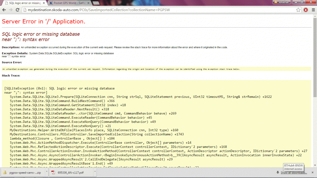

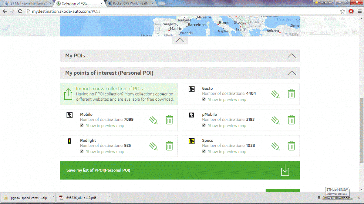

I have downloaded the pocketgpsworld speed camera files as .asc (having also tried .csv and .gpx) and they are uploaded successfully to web portal as you can see from picture 1, but when I try and save so I get the zip file to extract onto second sd card I get an error message (picture 2).
I'm assuming it's something to do with file names and when I have .ASC in capitals I do get a zip file when saving but there is nothing on there that can be imported as a .vcf file I think into the Amundsen and also number of destinations shows as 0 unlike the examples in picture 1 where thousands are listed (eg mobile 7099).

@Brucey - though I'm not familiar with this, the error message might indicate that one of the names (or possibly the content) might include a semi-colon where the processing doesn't expect it. Since the semi-colon is special to the database engine (we can see that they are using the SQLLite database, which is poor web security, really, but that's another issue), it might be that which is causing the thing to get upset.
Maybe check the data for any ";" characters in titles/names, or try smaller sets to start with and work up to the whole lot - that way it might work for small sets and suddenly start having a problem and you'll know it's with the last set added incrementally.
Not a lot of help, but maybe something to check.
