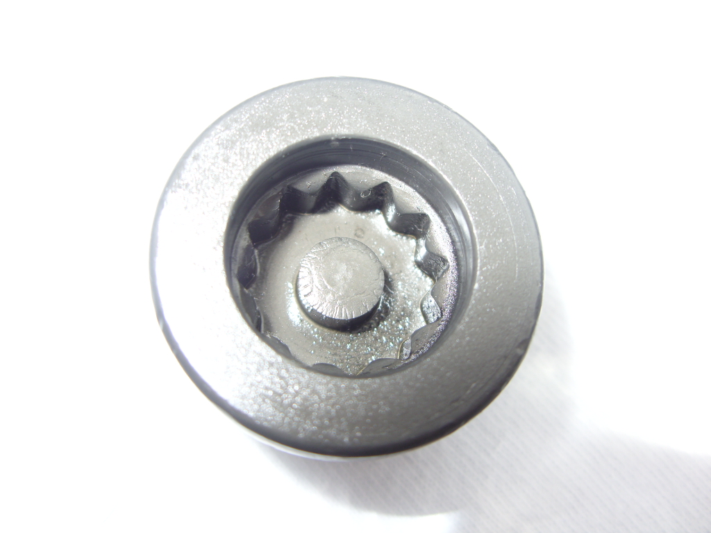

Just finished renewing gearbox oil on my 2005 Fabia MK1 VRS.
My filler & drain plug different to yours have attached picture, filler & level plug had a steel washer.
Oil looked murky and stinks to high heaven, beware getting it on yourself and clothes, people will smell you before seeing you..LOL
