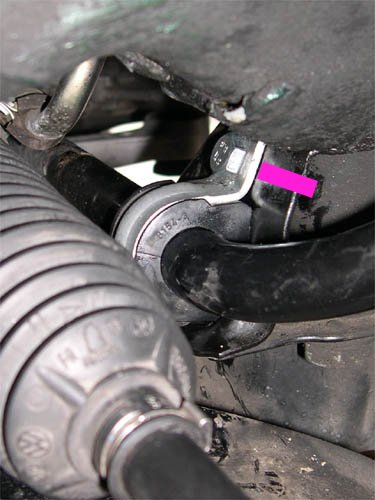

I have upgraded my anti roll bar bushes to poly ones on my octy mk 1 vrs and cannot seem to get the passenger side bolt back in to secure it to the car. The drivers side went back in fine as i have more room to get my hands in. The passenger side bolt i can get finger tight but as soon as a ratchet gets near it pops out. There seems to be a large gap between the bush and the bracket but the bracket isnt bent. Any advice or tricks to get the bolt in !

Would be better sticking a picture up, as a picture tells a story of it's own, just be careful though with trying to screw the bolt back in you haven't damaged any of the threads.
Yeah no worries thanks will try a picture not with the car for a while !. The threads are fine as screws in when i tried it without the bush or bracket its not a long bolt and has to go in almost 3/4 of the way before it takes !! Nightmare :)

Use the longer bolt to pull the bracket down round the bush, then fit original bolt.
Used longer bolts using oem replacement bushes on mine. New rubber/poly is a lot stiffer and needs mega pressure to push in on with the standard bolts..
I used some needle nose grips to hold the clamp down when I did mine.
Pinching the clamp is the better method. If you use a longer bolt make sure it not too long as there isn't an infinite depth behind it.
