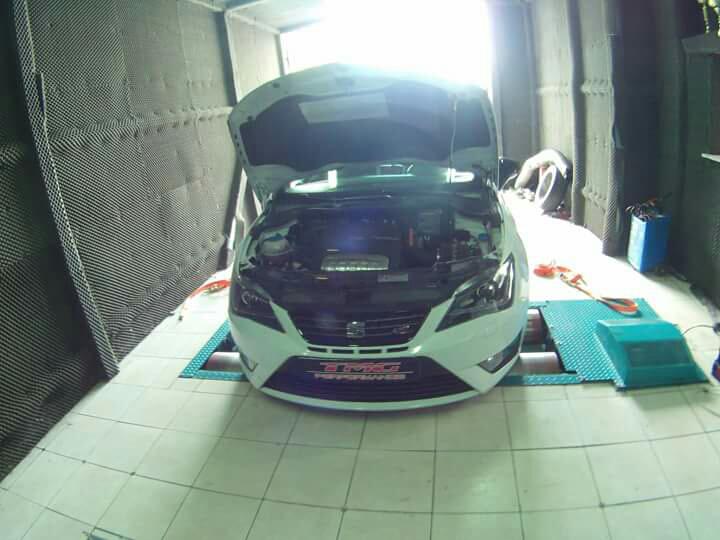

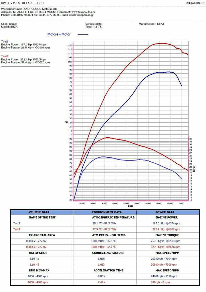

Out of curiosity I contacted my tuner (TMG Greece) and asked him what's the story with CTHE engines. Says they've been mapping them fine since earlier this year. Sent me a couple of shots from a CTHE Cupra that was there a while ago. 187bhp as stock going to 222 with upgraded intercooler and exhaust:
Says they can be mapped via OBD as well (jealous!!) although this might not make much sense in a UK forum. I also had to go down the road of sending him my ECU via post as I'm now based a few thousand km's away and tunred out just fine, although not being on the dyno meant we went a bit lower than expected.

Don't know about the CTHE vRS particularities with the OBD but as I said since the company is based in Greece this isn't of much importance as I don't think many would travel there for a remap.
The ECU removal and shipment is always an option for those wanting to have a remap right now and actually my post was rather addressed to Sharkrider asking for before/after runs on CTHE so I just provided one.
What's more interesting, from the looks of it, it seems that end results are the same as CAVE engines, 210-215 for a Stage 1 and ~222 for Stage 2 so any starting difference between CAVE and CTHE is lost after maps, hence less bhp per buck if you like.

thats cool, proof its being done..... BUT The latest CTHE RR run I saw gave 198bhp..... I have seen about 4-5 RR runs of different CTHE cars giving 195-201 bhp........ (standard) .....
IF they did before and after and showed the 20 bhp increase, brilliant , we have a winner :) (even if it was Toms 198 bhp car, that showed 180bhp on their rollers then 200, its a winner)
edit : the area under the graph looks quite good too... better than the 20 bhp increse may suggest... means it might feel even better on the road....

Mines went from 185-205bhp so yeah it was a 20bhp increase. But the way it drives was a big difference. Even the way it starts is so much better. I was disappointed in the numbers as I was expecting more but I was very happy about the way the car feels.
