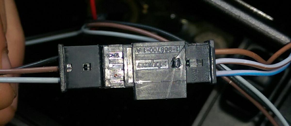

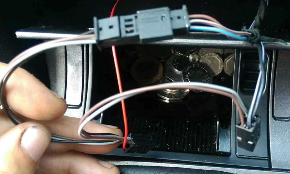

Probably easier to post pics:
All
Basically the small black plug that takes the wires from the rear of the asr switch. Brown asr goes to black, asr grey with brown stripe goes to brown, asr grey with blue stripe goes to grey. The wires you take out of the asr do them one at a time. Then using the grey blue stripe as an example, follow the grey wire down to tpms switch and you will see there is another grey wire in the same pin on switch. That goes into asr switch where the grey blue stripe came from.same for all the others. Sorry I'm **** at describing things :)
Behind govebox there is a big clump of wires to the left and up. There is a grommet that comes out near to abs pump, tape the red wire to a coat hanger and push it through there.
