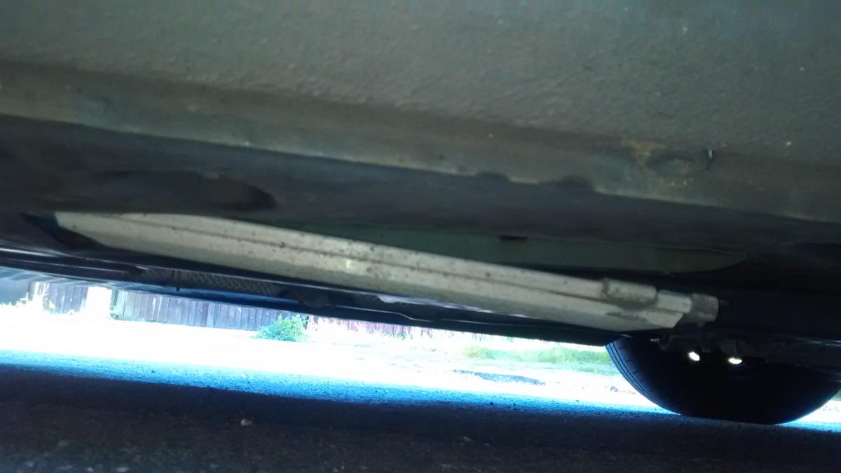

I was walking back towards my car today and noticed something hanging down on the driver's side just below the driver's door underneath.  What is this and how can I fix it?
Many thanks,
Jim
(apologies for bad photo, will take more tomorrow when I have better light)
Edited by jimjazzuk
Might help if you say what car you have too....
Oops! 5 door 2005 Skoda Octavia II
I think it's the fuel cooler
Yes its the fuel cooler
Gosh that sounds important.  Should I try to tie it up for now until I can get it booked into the garage? It has become detached at the front end is hanging about an inch below where it should be attached.  Has anyone had this happen to their Skoda? Any advice?
Yes indeed it should be secured before you drive again. If a diesel fuel cooler becomes detached partly or completely and is ruptured or the fuel lines become damaged the resulting diesel spill could result in the death of some unsuspecting biker, either travelling in your wake or passing over the spill long after you've gone. Diesel spills are lethal for two wheelers, especially on wet roads.
Thanks everyone.  I've cabled tied the loose cooler to the panels under the car now until I get it into the garage in a few days.  I'm hoping the cooler doesn't get so hot that it melts the cable ties!
