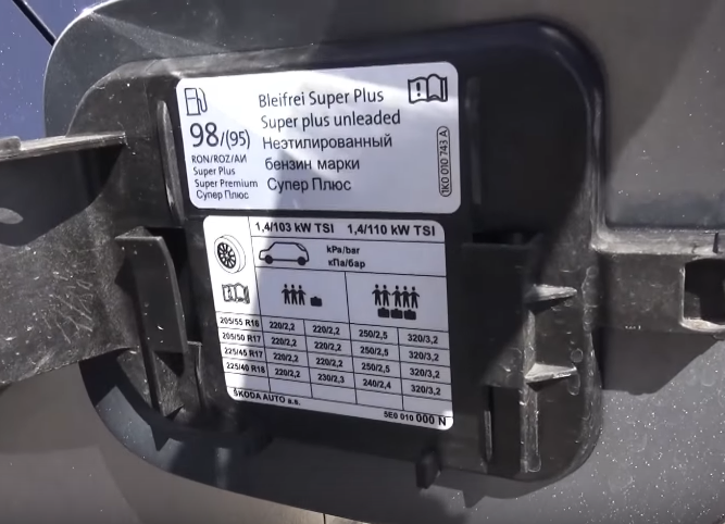

On the petrol flap it states Super unleaded 95 ron minimum. Super unleaded is 97 ron here in the UK. What do other owners use in their 1.2 tsi engines?
In Europe super unleaded is 95 RON and super plus is 98 RON. UK 95 RON will be fine.
Normal unleaded in the UK will be fine.

A bit late, but better late than never: After reading this, I looked into the subject further.....95 is the minimum,  98 max.  ( '15 Roomster 1.2tsi)
Assuming the electronics adjusts for different fuel grades, then what we get around here is 95 or 99, 99 being too expensive and over the top.

It is not 98 ron 'Max' ,  that is just what VW Group Show on Filler Flaps as the 'Recommended Fuel'  They use different names for Premium / Super fuels/ Super Plus,
and seem to not bother that UK Retailers stopped selling 98 ron.
http://volkswagen.co.uk/need-help/owners/Fuel
