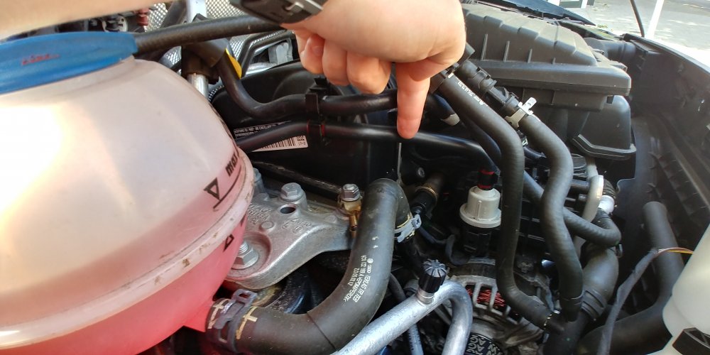

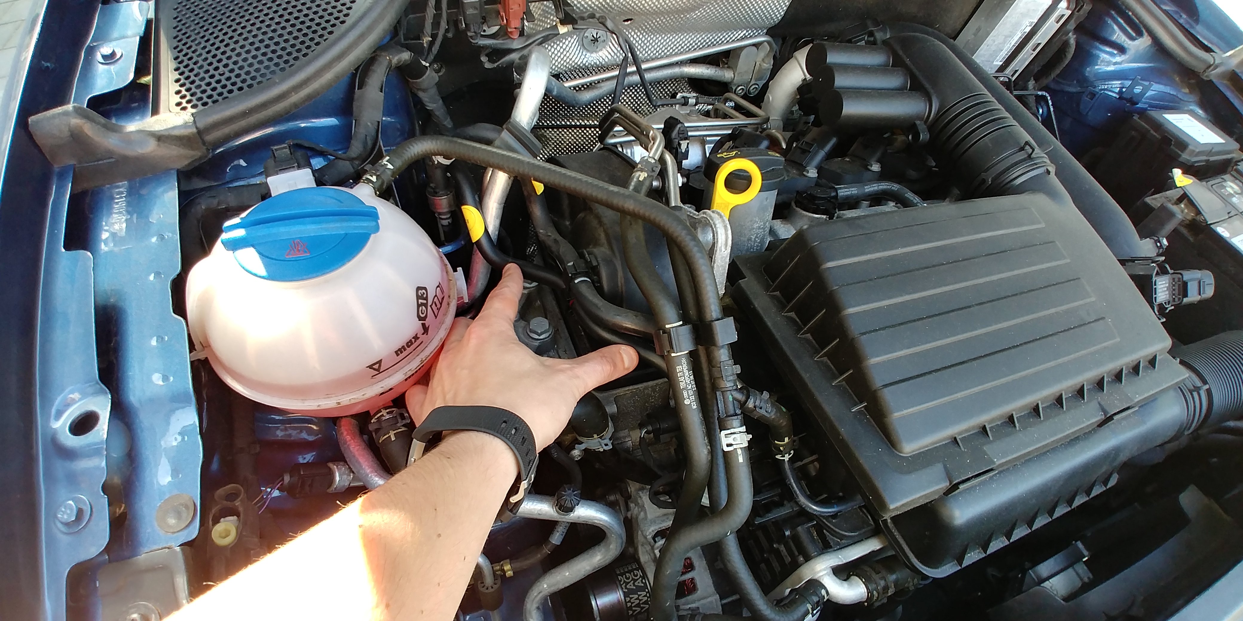

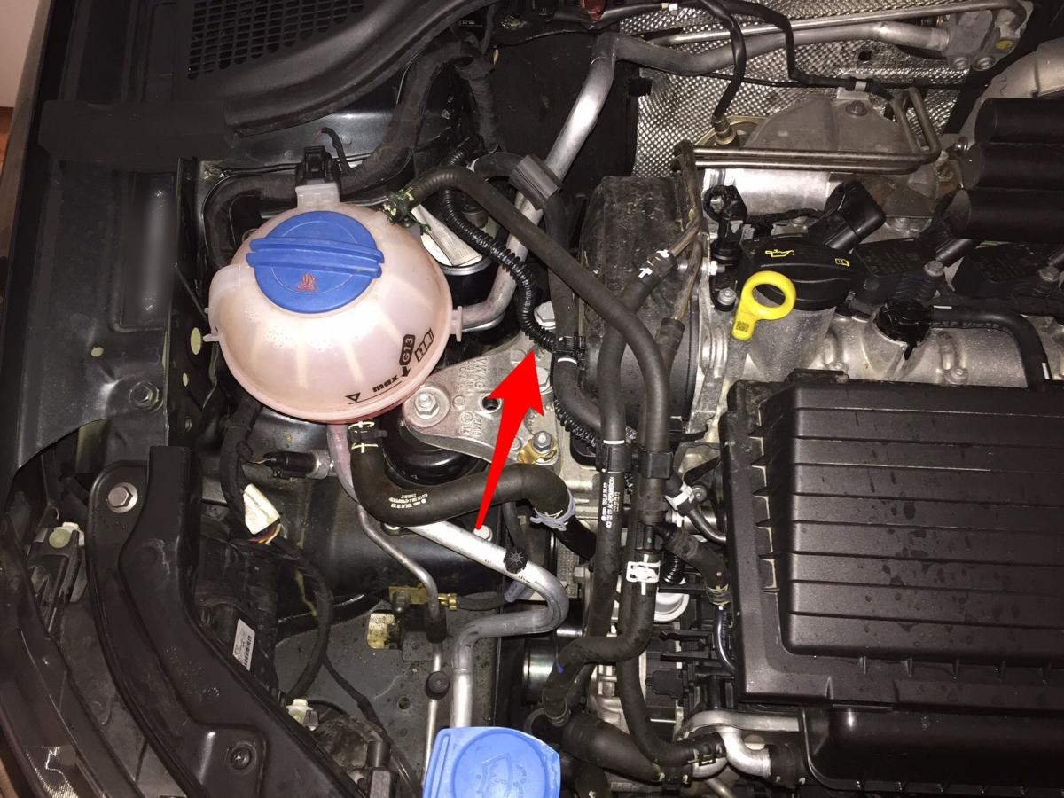

Where is the part located? I hope the mechanics understand the English part name but if they don't, I'd like to be sure that I can show them what I'm talking about.
It should take the mechanic less than a minute to replace the hose (but they'll probably need to order the new one for you first - as they probably don't have spare parts like this). I stood there when he replaced mine, it's really simple.
You can see the hose in the attached pic:
