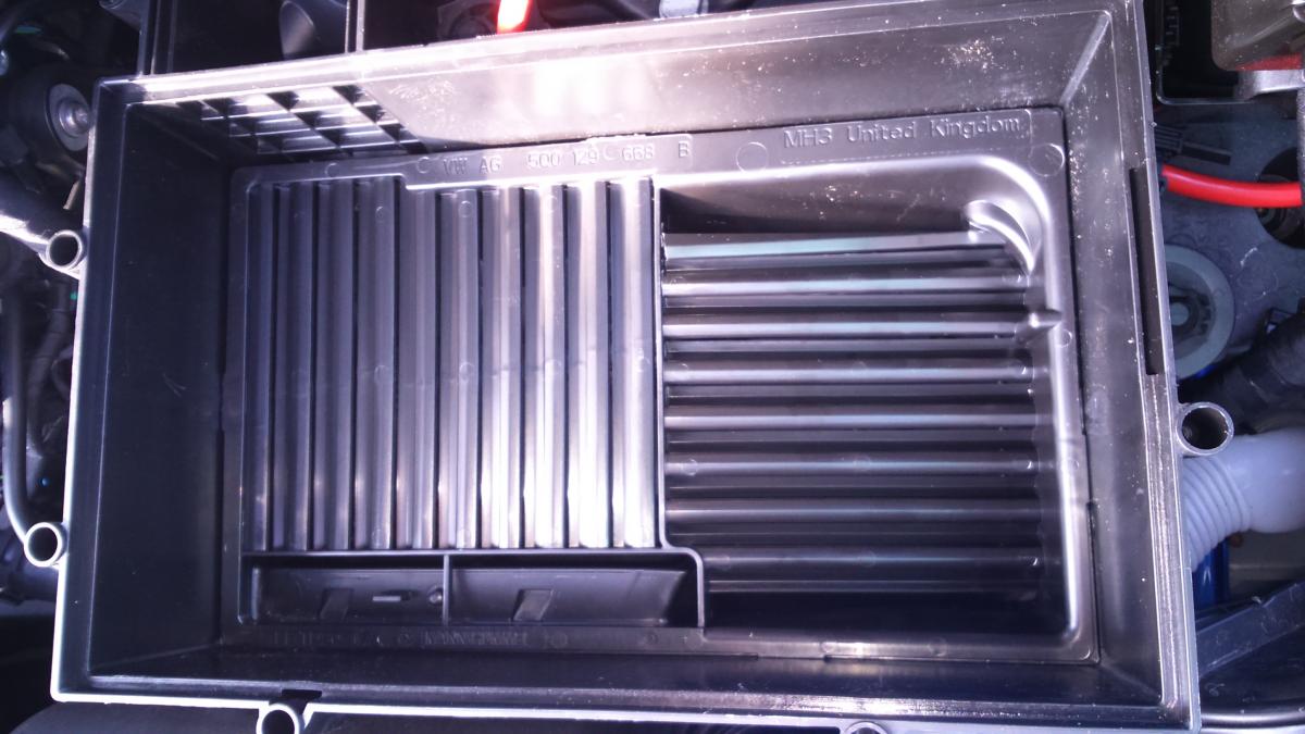

Just got my car back from the bodyshop this afternoon (had the roof painted to match the sunroof surround), while it was away a new K&N panel filter arrived which I cracked on fitted as soon as i got home with the car, has anybody seen the size of a standard filter!

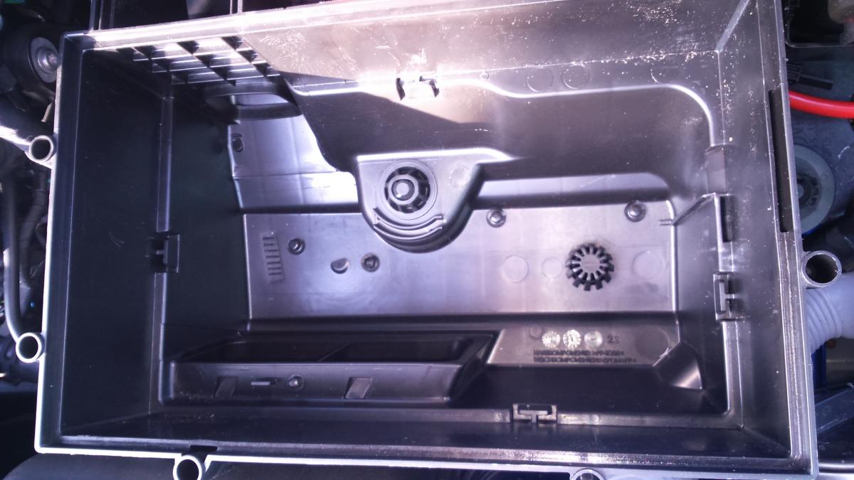

Not only the size of the filter but in the bottom of the airbox there's like a baffle type insert, obviously to reduce the intake noise, but absolutely no good for air flow.
Also at the back of the airbox there's a hole which goes to nowhere, again I guess it's something to do with noise reduction but it certainly doesn't do anything to aid airflow.
Anyway to the main point, having removed said standard filter and associated noise reduction cr*p and fitted the K&N panel filter the car definitely is more willing throughout the rev range.

That noise reduction piece of cr*p that you refer of is a snow strainer.
It is designed to prevent snow / water ingress into the air intake, and thus damage the air filter (OEM filter is paper) and associated sensors.  If the filter gets wet it will block / become more restricted as the moisture / dust mix.  If the filter is wet when it is cold, it may freeze, also restricting the air intake.
In addition, moisture / restriction are not too good for the Mass Air Flow (MAF) sensor that controls the fuelling of the car - if the MAF is subject to moisture or soiling it will result in a reduction in engine power output, because a lower injection quantity is calculated.

I removed that baffle from mine some time ago and its been fine. Seen a couple of clips in German, on youtube, where similar was done.
What's the baffle? The plastic thing in the bottom of filter box?
Yes. Or snow strainer as it is referred to in the Skoda service manual.

Took mine out on my mk2FL diesel didn't really do much so put it back again (the baffle that is).
