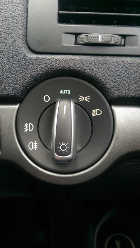

Quick update, got an Octavia specific auto headlamp switch from Ali express for £9. Used it with the auto headlamp loom. Lights up green and function with the loom is perfect. Fitment is tidier too.
Do you have a link to the one you purchased?
Search Ali express for: OEM 1Z0 941 431K Head Lamp Switch for Skoda. I use the app on my phone and can't find a way to copy the link. I used the car last night for the first time in the evening. Interesting to see that it has a few stages, side lights only as it starts to get dark, then switches to dipped beam as gets darker. Then ignition off around 30 seconds of coming home side lights.
