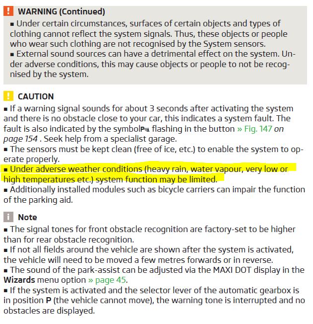

I suspect that my issue is down to the very heavy drizzle that was about at the time....  I have just been out now the sun has been shining for a couple of hours (yes, that unusual thing called the sun Lol) driven out of the space, and reversed back, all it seemed to pick up was the car on the nearside ... So maybe water is an issue...
It was a real heavy drizzle, almost like fog, and reading the manual it seems that this can cause issues!
