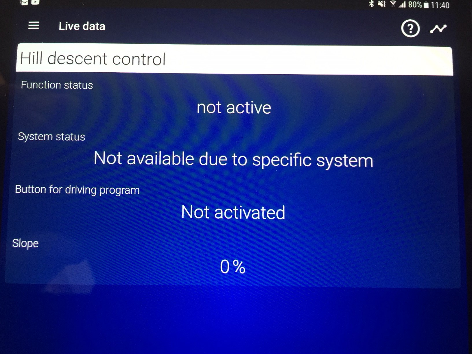

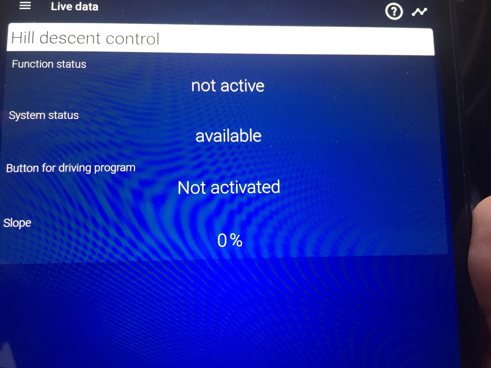

I've got an important update :-)
As I've seen in another topic from Marcone (this one: Kodiaq offroad retrofit ) that he was able to activate Offroad mode in module 3 (ABS) by changing a single bit (+1024 in byte 24, so bit 3 on)....
I've been trying to compare my ABS 3 map with a Golf Alltrack map....
..then I realized the Alltrack ABS map had ONE MORE byte at the end (30 instead of 29)...
...so I realized that my byte 23, compared to the Alltrack map, was missing exactly the byte 23, bit 3...
This is the outcome (I used obd11 as I was at the office, without my pc):
Before the change (SYSTEM NOT AVAILABLE): before.thumb.JPG.b1605b7029177ae28d6ac22f9e8a936a.JPG
After the change (system AVAILABLE!) after.thumb.JPG.404aa03b6b4ff8f4caf2cabf5487a88a.JPG
This is a good step! It is clearly not enough, however, as I have now to find a way to "make visibile" in the graphic menu available when the "mode" button is pressed the additional "offroad" profile.
Does somebody wants to help?
(In a nutshell: modification to make available the hill descent mode is: MODULE 3 ABS, BYTE (total number of available bytes - 6), BIT 3=1)
Edited by halfmillion
