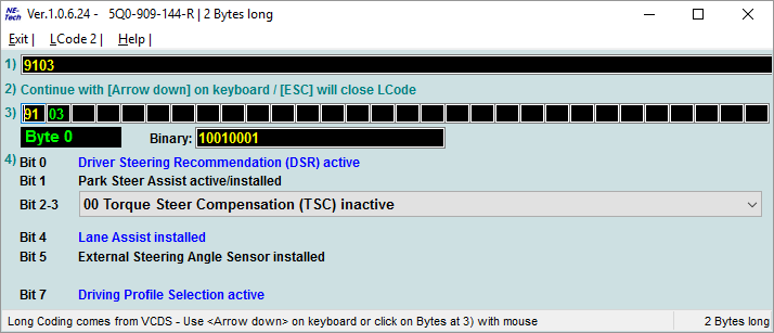

Byte 0 on 44-Steering Assist is as follows:
And the various adaptation maps are:
