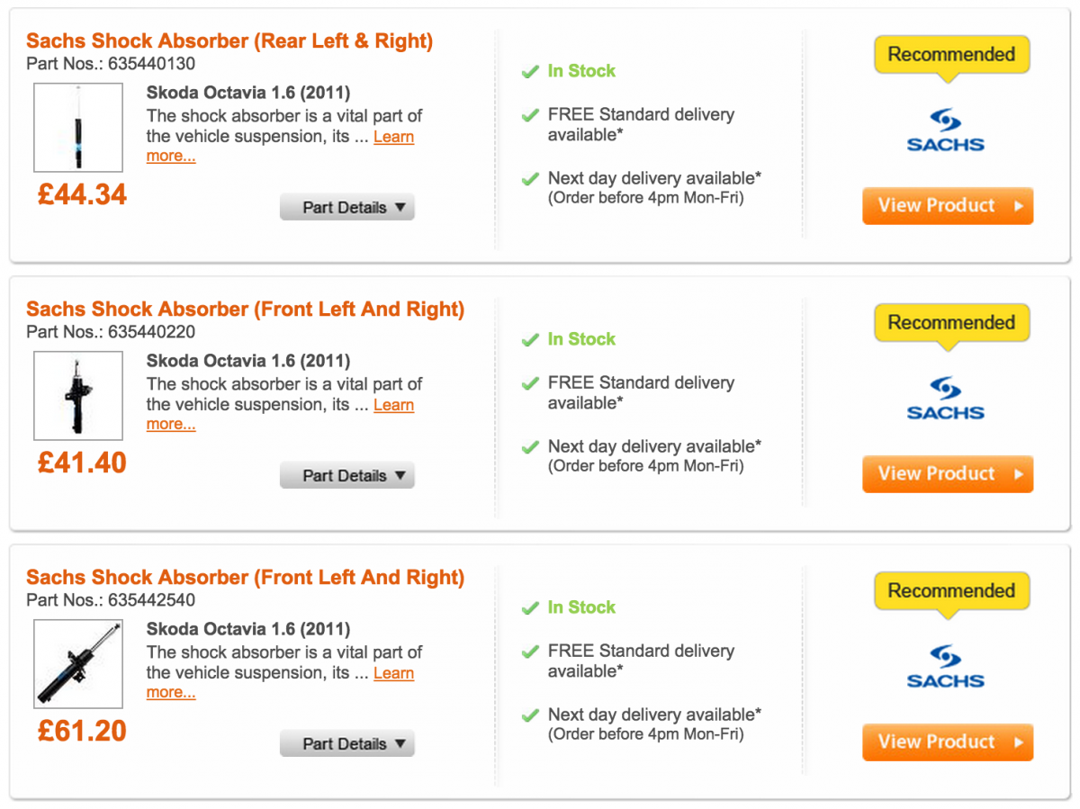

I am about to change my front shock absorber and found out there are 2 types, one with 50cm housing diameter and one with 55cm. Does anyone knows how to find out which one is best for my car?
I have a 2011 Skoda Octavia Estate 1.6TDI DSG.
Attached is a picture with what I found, the second one is 50cm diameter and the 3rd one is 55cm. I understand that is related to the spring, but how should i know which one best fit?

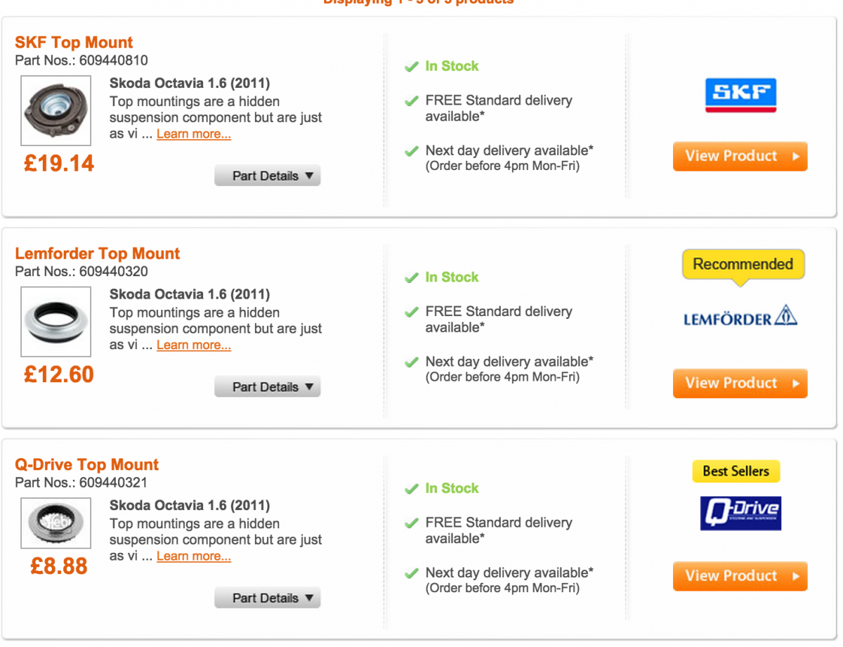

Also, my mechanic told me I need to replace the top mount as well, does anyone knows which one will fit my car?
Mines is a 2012 manual. Just replaced two fronts & mines where 50mm ones, you'd be aswell changing top mounts also.... Your in that area and will come off with suspension so why not?

thanks for your replies, my wonder was if I need to order a 55cm diameter or 50cm one.. I don't know where can I find this information.

Just gave TPS a call and it came out as £182.00 both, without the top mounting. I have found on another place Sachs or Anschler for half of that price. However, they were unable to tell me what housing diameter I should order.

The SKF top mount looks right.  The others look like parts are missing.

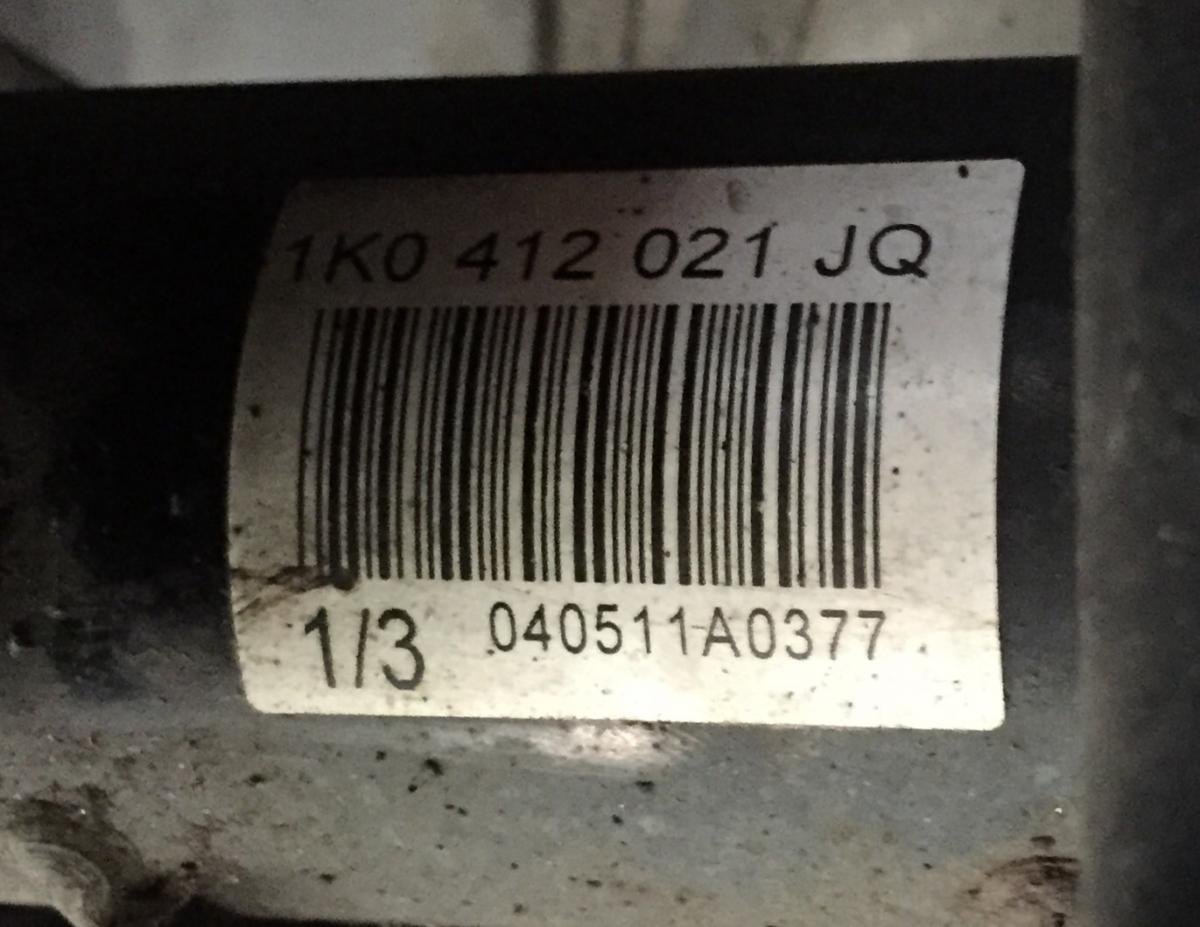

I am unable to measure the diameter, there is no space to do it. I have however took a picture with something that i believe is supose to be the part number, but i dont know how to search for that number. Is there a place where you can enter the part number and tells you the part?

1K0 is 50mm
1T0 is 55mm
