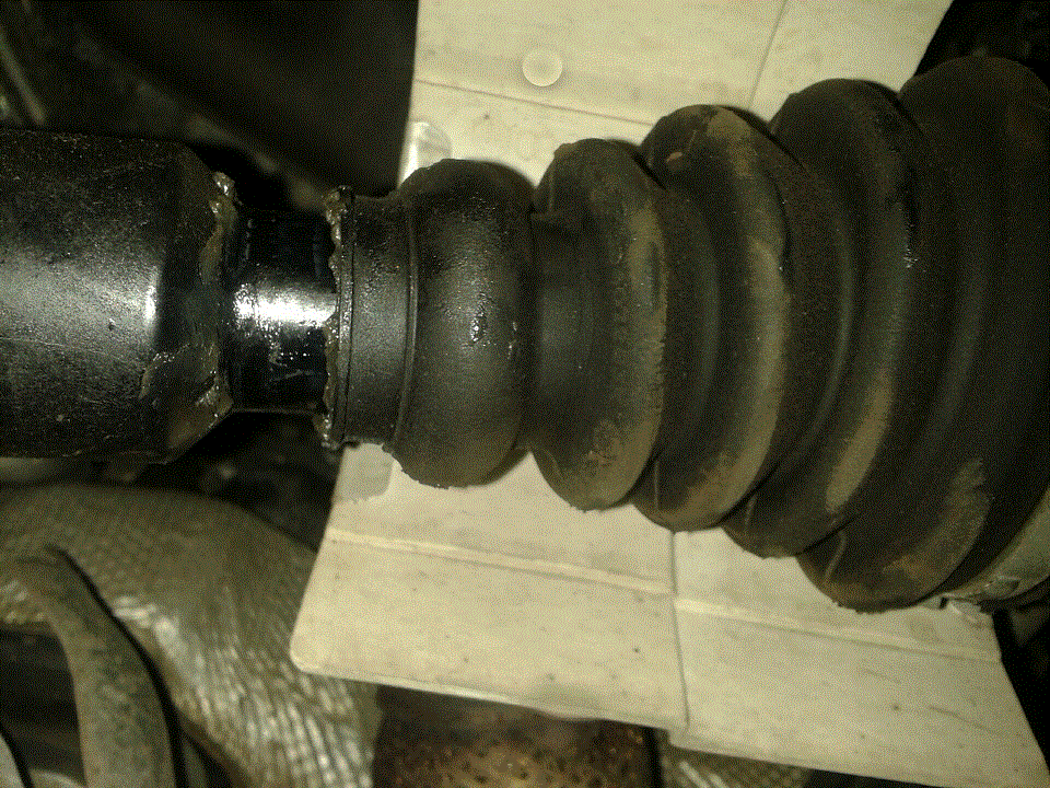

Only thing I found was a loose gator on the nearside. Could have leaked grease and caused damage? Had that before on another car but the grease sprayed everywhere. I did smell some burning occasionaly, could have been drops of grease on the exhaust.

If that gaiter has gone and grease is lost the heat and dirt would have got to it eventually, the crack you heard could have been something collapsing in the joint but play in the shaft would be very noticeable. Could be a spring, very hard to say without having a dig about though.
