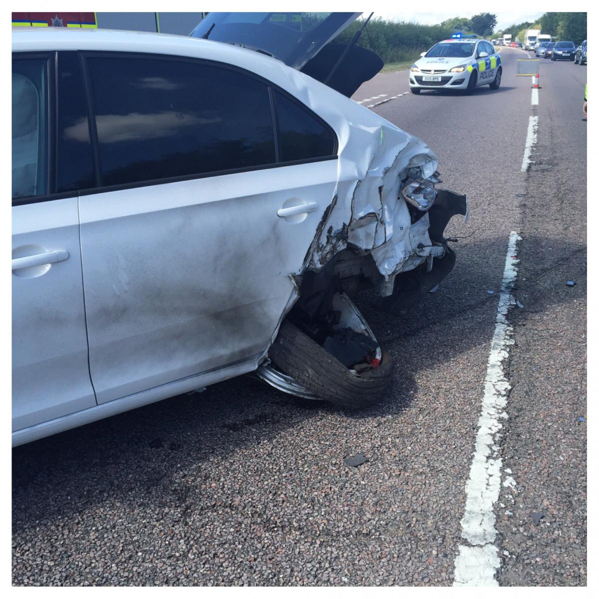

Really? I'm gonna get me some of these then:
Not sure they'll help my issue regarding our hand break!
I hate seeing that photo :(
