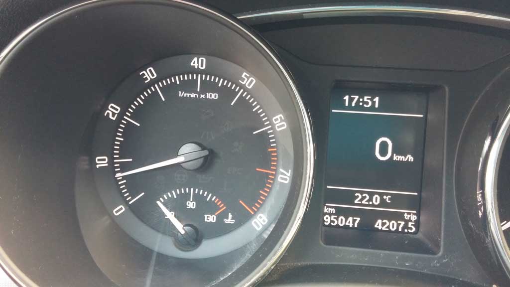

Hi,
I'm owning a Skoda Superb 1.4TSI, 2011, 95000km and recently I noticed that there is something strange with the car when it's started for the first time. Normally, upon startup, the rev is below 1000 and the engine is pretty quiet. However, for the last couple of months, when the car is started for the first time (for example in the morning), the rev goes up to more than 1000 and as the result, the engine becomes a lot noisier. If I stop the engine (even for as short as 5-10 seconds), the rev & engine noise get back to normal for any subsequent starts. The same thing happens if I wait for about 30secs to 1 minute without stopping the engine & restarting.
In addition to those symptoms, I also noticed some sort of degradation of the car performance, for example, the steering wheel gets a bit stiffer, the car is not as smooth as it usually is etc.
Has anybody experienced the similar issue with Superb or other Skoda cars and what can be the source of the problem?
