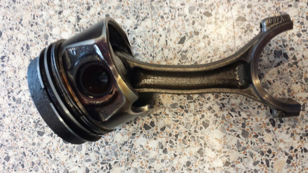

update for the problem with my car so far.  Two problems, the misfire was a bent conrod.  the rattle at idle I have been told is the flywheel.  getting this done tomorrow so will update if all is cured.  Shane at SWADS found out the engine problem in one day.  Engine sweet as a nut again now to sort out that rattle
pic of bent conrod
How the heck did that happen? People who seriously modify their engines (In a more than doubling the power output kind of way) are the only ones I've heard of running in to this. Was it on the cylinder with the injector issue?
it was water damage
not sure of all the technicalities, but that was what caused it
yes on the cylinder with the injector issue
The only way I can think of for water damage to do this is if enough water gets taken into the engine instead of air to fill the cylinder and stall out the engine thanks to water being effectively incompressible compared to air. Usually if this happens the whole engine is probably dead and you'll definitely notice it when it happens as you'll probably be in a couple of feet of water.
