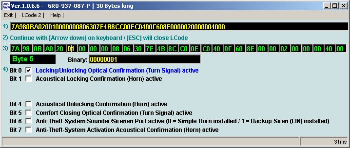

yes, you could do it with vcds..this is image from my Rapid (bit 0)

Yes it can be done but needs VCDS or a dealer to do it.
There is a list of VCDS owners in my signature
Thanks for the screenshot.
And thanks for the map of VCDS owners.
