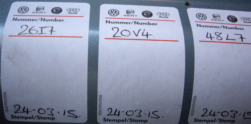

Next to the data sticker in the boot of my Rapid Spaceback are 3 other stickers, each with a 4-character code.
The codes are 26I7 (TWO-SIX-EYE-SEVEN), 20V4, and 48L7
Does anyone know where I can find thier meaning?
And does anyone know where I can find the meanings of the 3-character codes on the main data sticker?
Many thanks - Richard
Lee01 not gonna work, equipment codes have length equal to three.
48L7 does seem very familiar, but i cannot recal where have i seen it :-/
I suggest you try something new-fangled called Google - its a search thingy that apparently finds information for you.
2 seconds later:               http://vag-codes.info/vag-option-codes
thats the 3 figure codes sorted - struggling with the 4 digit ones at the moment.
Edited by camelspyyder
Yes they are 'recall' stickers. Found two of those applied to our Spaceback boot following the last service.
TP
Big ugly things to stick there.
Thanks all - looks like I have the power steering software upgrade, and the replacement throttle pedal, not sure what the third 4-character code is yet. They applied all of these in March, shortly before I collected it as a 2nd hand purchase form my local dealer.

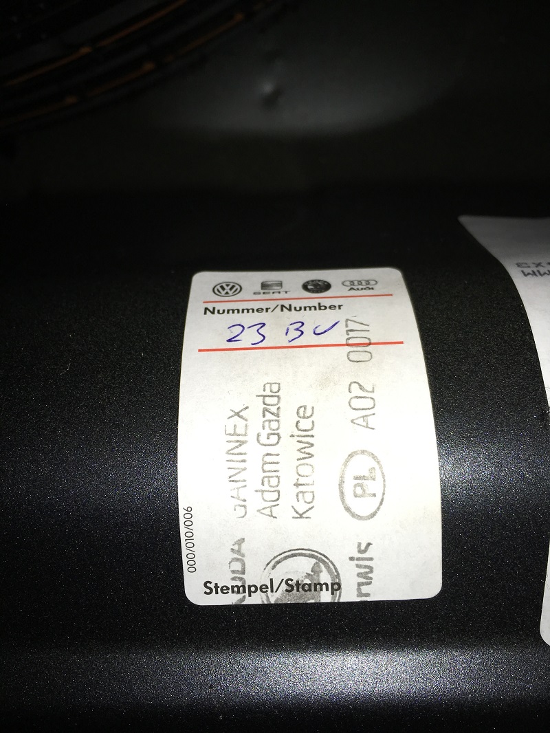

Hello,
Can anyone help me figure out this recall / software update code? It can be 23BU or 23BC...
Edited by sebkoch
try the link at post #6 and enter your VIN
It shows nothing. And I think its correct because the recall action / update was already done to my car...
at least there are no other outstanding recalls.  :happy:
