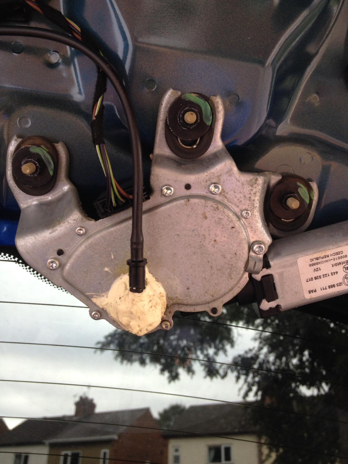

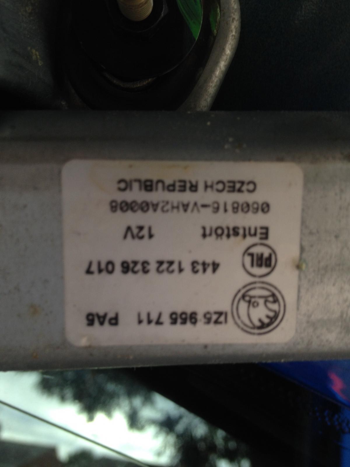

Finally got round to pulling boot plastic off and yay it's been siliconed bodged up and the motor its self looks rusty so new unit for me seen some genuine looking ones on eBay for £71 not sure if paying for a second hand unit is the way to go will post some pics

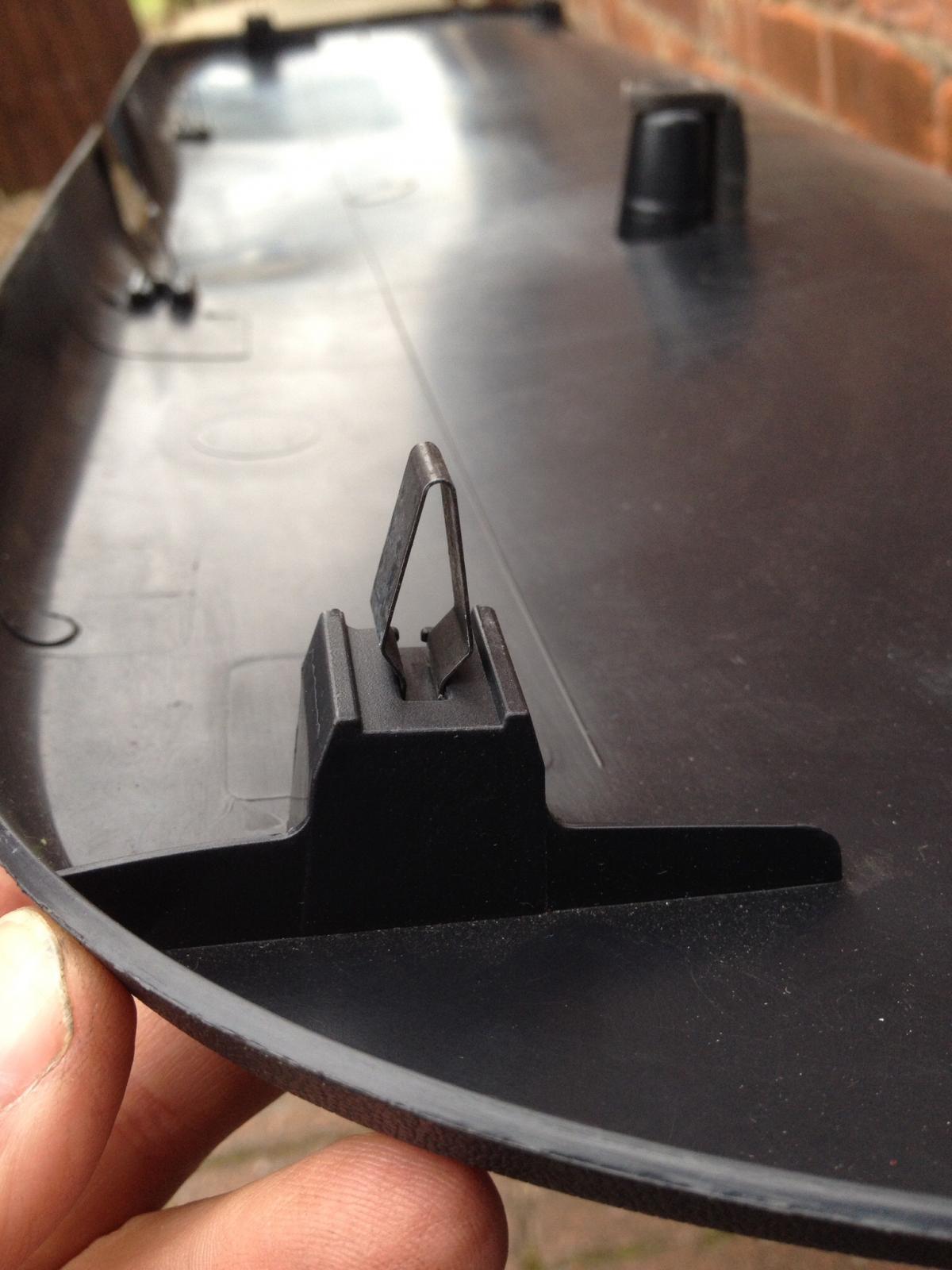

Also missing a few of the metal spring clips too they dealer only ?
The clips cost pence from the dealer.
