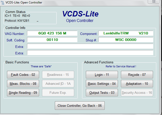

VCDS-Lite shows the following info:

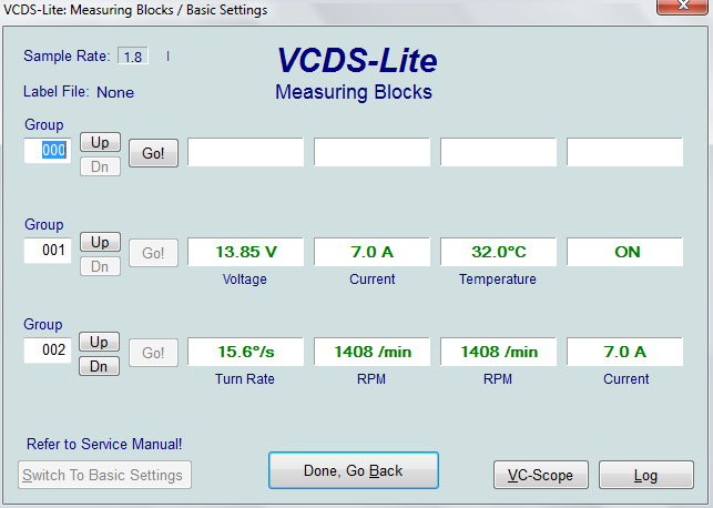

And "measuring blocks" with engine running while turning the wheel:
Apparently VCDS sees the pump as healthy.

7A current draw from the PAS pump is very low, it suggests the pump is in low power mode.

Can you log measuring blocks 1,2 & 4 of the steering assist module while you're driving for ten minutes or so?

Wino: Certainly. Just logged a ride around town.

Look at the coding; 00110 in the first picture, I've mucked about with the codings and all of them are too light, no this is something else.

This is the scatter plot of terminal 30 voltage against pump current for your logged journey:
Your battery and charging system seem to me to be good.  The pump is never causing the battery voltage to dip too much.
Looking at your turn rate column versus pump current though, it looks a bit strange.  It's too late and I've had a little too much nice red wine to be sure, but I don't think my pump current ever drops below 3A in any log I've taken. Yours seems to drop below that, right to zero, quite often. Also, look at around row 283 onwards of your log; there's a time there where your turn rate starts registering quite big numbers, but your pump current is actually going down? This may be because your road speed is high, meaning not so much assistance is specified, but I find that strange/illogical.
The maximum pump current does seem low also, compared with all the logs I've seen.  I can't think of a simple explanation for these data just now.  Maybe tomorrow will bring more clarity.
So, now it's morning and I've had another look at your data, and my last log taken on Friday in my Polo.  My pump current does drop below 3A sometimes, so I think that 'abnormality' was a figment of my imagination.
Also, in my last scatter plot, there are only two points of higher current than yours (turning sharp right into my parking space at work, low speed, low revs; Time stamp 613 is the 37A one, the one above it that I've managed to crop out is the 33A one with a turn rate of 382), otherwise the plots look pretty similar:
The pump current (I Pump, above in two columns) doesn't always correlate immediately with turn rate, and sometimes differs dramatically between samples (TS, above in 3 columns) only 1/3 second apart.  So the absence of any big numbers in your plot may just be that the sampling missed the highest peaks.
Your charging voltage is a little lower, but not enough to make a big difference to your power steering, I don't think.
So I'm not convinced there is anything wrong with your pump.  You even have "Correct" in your sensor reference voltage column, which is interesting. I was half convinced that voltage was only relevant to Koyo sensors, as both cars I have access to say Too Low there, and nothing seems wrong with the PAS on either. :think:
