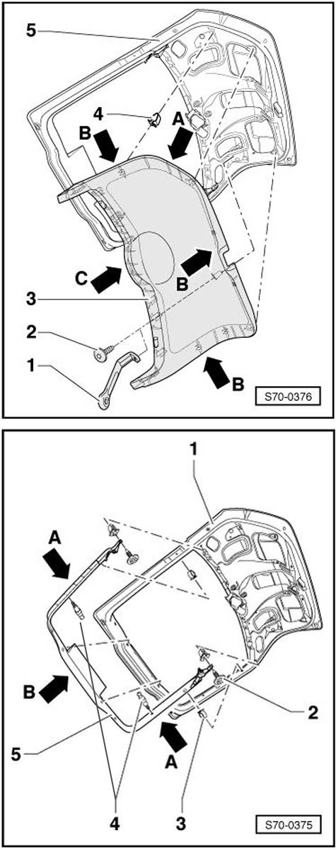

The trims aren't that bad to remove (done it too many times!)
As for clips, try S4B0867276A. It's listed as "clamp" but I got 6 of these @ 0.54p ea for my tailgate trim. Just beware there're a couple of clips that differ slightly, they're set at 90deg to the rest. A bit difficult to explain but with the trim off they're nearer the middle as opposed to edge clips.
Hope that helps.

With the picture you posted - it's the top most one that I'm trying to do. I can open the boot and place both hands on that trim and "simulate slight vibration" and all I here is squeak, squeak, rattle, rattle.
I've tried to be clever with "no more nails" tape in the gaps, but cannot help feeling it wants removing and all the clips replacing. Just when the mechanics took a quick look they thought the trim may have been damaged when the ham-fisted Autoglass guy had his hands on it.

I've had that trim off several times (earlier thread on rattle) and it's really quite easy. Referring to the previous top image,
Removing:
Remove fixing screw -2- (1.5 Nm) of the door handle -1-.
Loosen bottom trim panel for tailgate -3- at rear and on the sides -arrows B- with edge -3409- (begin in the area of the -arrow A-).
Loosen bottom trim panel for tailgate -3- at front -arrow C- with edge -3409- and remove trim panel from the tailgate -5-.
Installing:
Installation is carried out in the reverse order; pay attention to the following points:
Recondition the clips -4- in the bottom trim panel for the tailgate -3-, if necessary replace with new ones.
These are Skoda instructions but basically work carefully around the edge of the trim with a wide flat tool. Remember, the clips are only push fit so will need a little effort to pull out.
The clips S4B0867276A can be bought in less than 10 pack if needed (I did). 54p ea for the clips.
Best of luck.

"wide flat tool" - Forgetting the "ooo errr missus" comments, something that looks like a metal ruler for example? Just slide it along the edges and effectively push the trim from the clips? Or am I actually removing the clips with the trim - they are attached more firmly to the trim than the tailgate?
I think once I've got the new trim I'll be more willing to be a little "rougher" with the old one, knowing I'm fitting a brand new one. And my plan is to remove and replace every single clip - hence my idea to buy the pack of 10 clips and the 2 retaining clips (I'm assuming they are the ones at a different angle you mentioned before).
Want it to be "all new" in the hope that will stock the squeak and rattle once and for all.

but a wallpaper scraper or similar would do equally well.
You're aiming to remove the clips with the trim, though some may be left in the tailgate (depends on how well they were initially fitted to the trim).
It really is more straightforward than you think.
