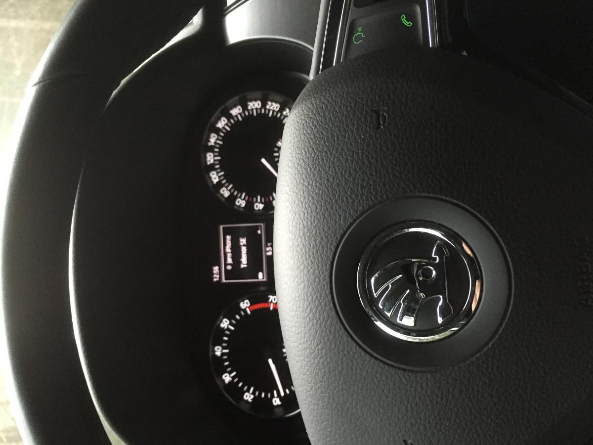

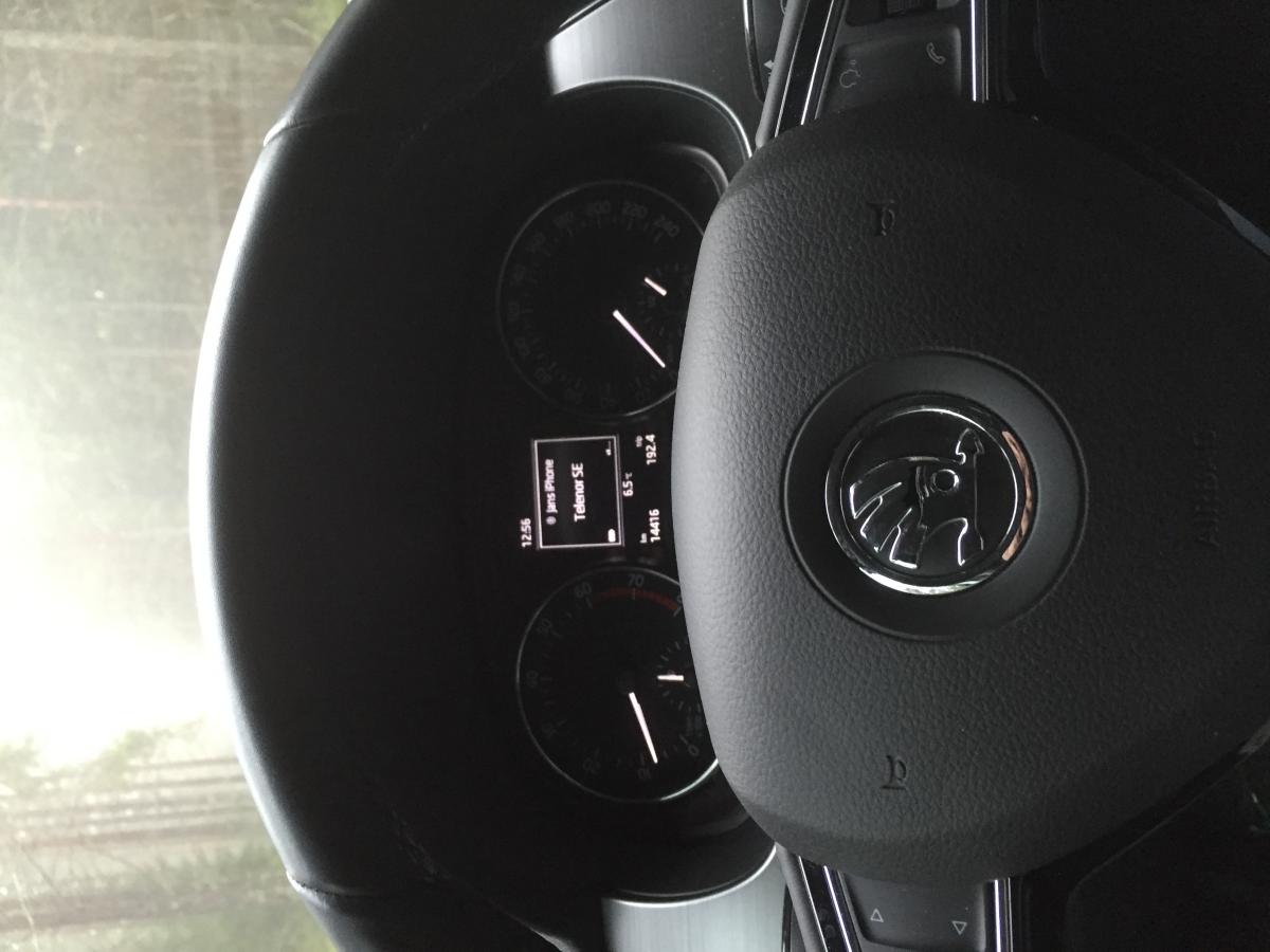

My instrument cluster light varies a little with ambient light and it normally lights bright when the leds are on and the sky is clear and sunny. But the crazy thing is that when it is "half dark" outside the instrument light disappers completly ( only the pointers and the centerpart of the instrument lights bright) and it will come back first when the automatic turns on the headlight. The dealer cant find the fault!!!!!
It's not a fault, the instrument cluster is dimming to make sure you turn the lights on as the ambient sensor detects that the light is low therefore prompting you to turn the full lights on.
It is still stupid. Why do I have to turn on the headlight manually when the light switch is set on automatic? The automatic should take care of that and switch on the headlight without dimming the clusterlight first,  otherwise it is a stupid design. One could think that the system do not have enough current for the relay or the transistor to turn on the headlight so it needs all it can get from the clusterlight.
I think this is done so that the cluster light should not be too bright when there is less ambient light. If you feel that the full lights turn on too late, you can change this is the car settings in the radio. I have not had to touch the light switch at all, I am perfectly happy with the way the car handles the lights. With auto setting you can get the high beams and fog lights on as well.
Thanks for your answer. I have set the cluster light for full strengh.  When it is sunny or  dark outside the cluster light is bright but when it is foggy or not so bright outside the cluster light is totally dark.
This photos show the difference in cluster lightpost-50995-0-10580800-1451130794_thumb.jpgpost-50995-0-80290400-1451130810_thumb.jpg

My lights are the same it seems to be all about the external ambient light suddenly in normal daylight you go through a shaded area the display disappears and only the pointers and centres are lit but you are in a situation where you would not normally put the lights on. I personally think the display should be lit all the time and you should use your own common sense as to when you need your lights on and not totally rely on the cars automated features. Joe

I agree that the display should be lit all the time not only the pointers and the center part. Hope some technical people from the Skoda factory read this and make a change in the future.
