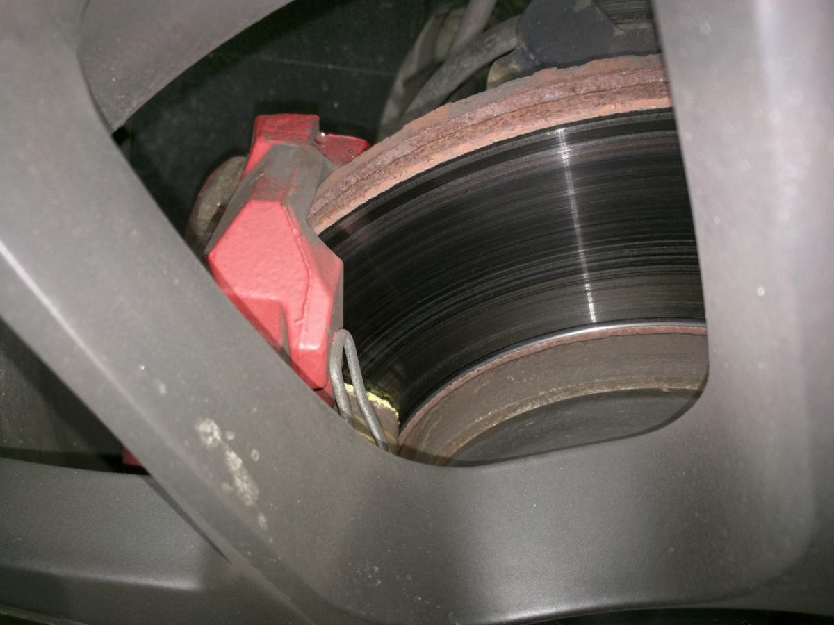

Now that you mention it, on my last lap after the final 20 min session, when depressing the brake pedal I felt it didn't really stop the car progressively as usual but it rather only acting at the very end of the pedal travel and with less force. That feeling remained on the way home. I doubt tyres became so worn and Motul RBF600 is supposed to cope easily with track use so... I'm hoping tomorrow morning they'll feel normal again??
Know how your brakes are feeling now. They will start to feel normal again by the end of the week. Even on the street now you probably feel like the car will not stop.

That's exactly how they felt this morning on my way to work. No increase on the stopping power regardless of how deep i was depressing the pedal, and a definite drop on the absolute stopping capability when fully depressed, seems like the car will not stop early enough during an emergency braking.
I will give them that week to get back in shape but if not i think fluid needs changing. Also you were quite right about corner exiting, i felt i had loads of power but couldn't do much with it. Whether it was XDS, tyres or a combination of both i don't know for sure. I just know the car catapulted forward as soon as wheels pointed back straight.

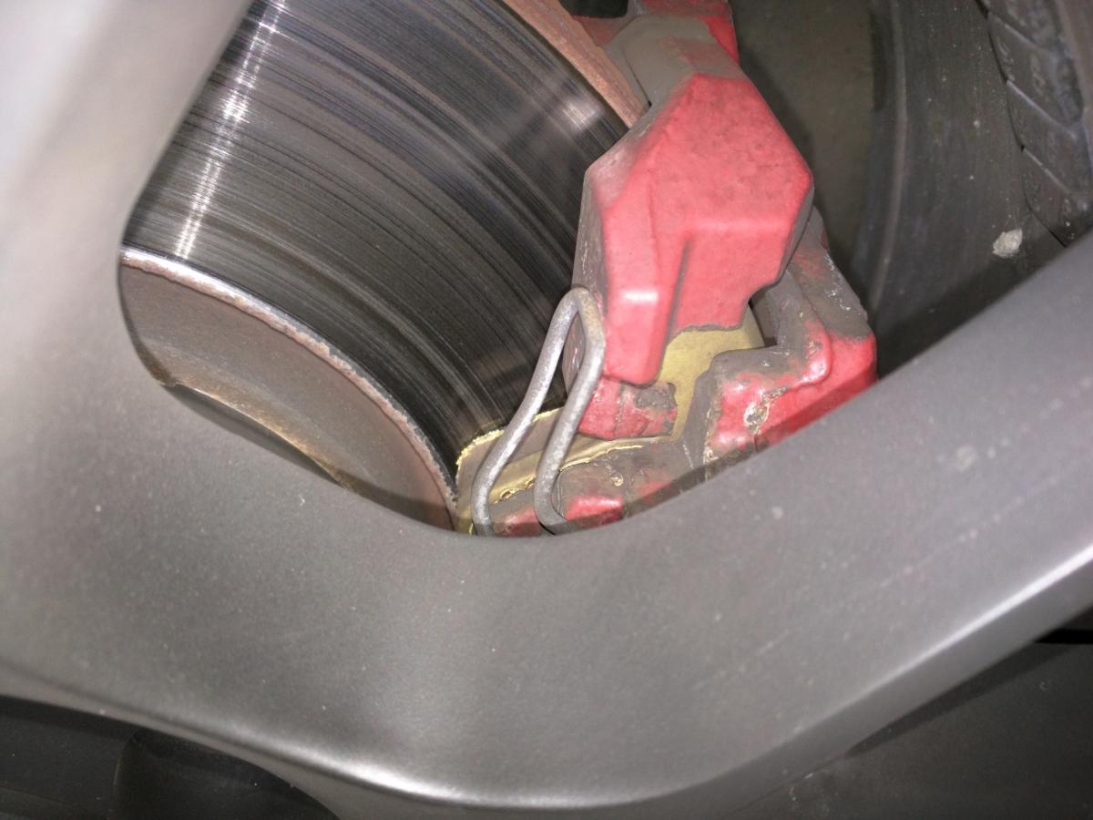

Strangely, I feel the brakes have almost returned to their pre-track state, how can it be? First two days i was convinced the fluid was done for and ordered some Motul 660 for a change but now I am almost sure they feel normal again. Or I became used to their feeling?
The brakes will never feel 100% as they did before as the pads will be warn down slightly so they will feel more like 95% of what they were before. I found that if you got too much heat into the brakes at the start of the day they would feel really bad for the next week. Using some cooling ducts for track days now and this prolongs the brake feel a bit as well as making them return to a normal feel quicker later in the week (obviously the ducts are removed before I leave the track). I use Penrite Racing brake fluid and all I can say is that you will need to be aware that this happens and to be a little easier on your brakes until you can upgrade them.
The only thing that I can think of that would cause the brakes to feel as they do would be the heat from the brakes glazing the disc or pad surface and making the pad/disc too shinny. This is why it takes a week or so before the glaze is removed and the brakes return to normal.
Yes they were looking ultra shinny. Here's some photos 3 days after the track, you can clearly see the caliper reflection on the disc.
So what's that heat glaze and how does it come and go exactly?
