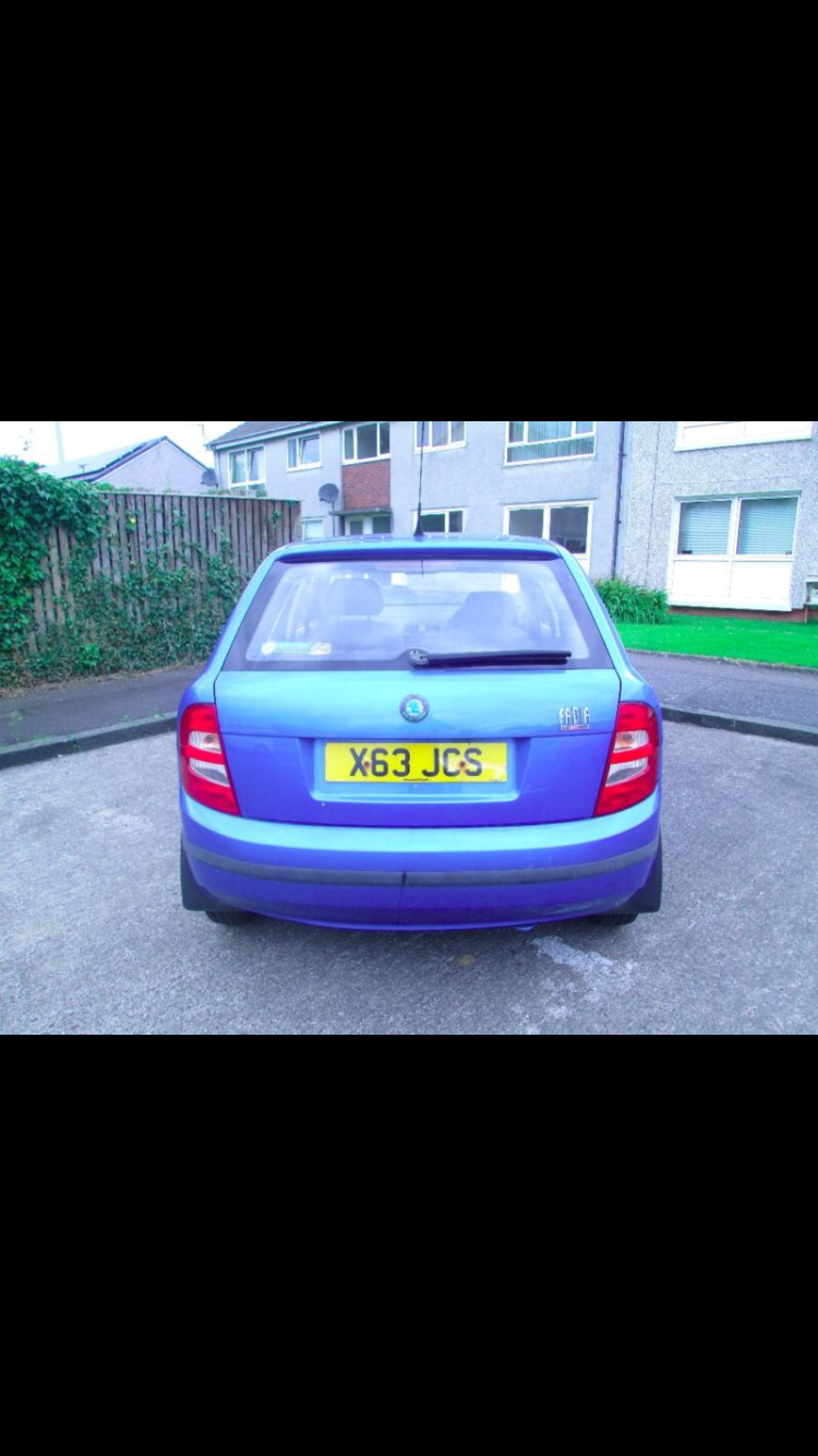

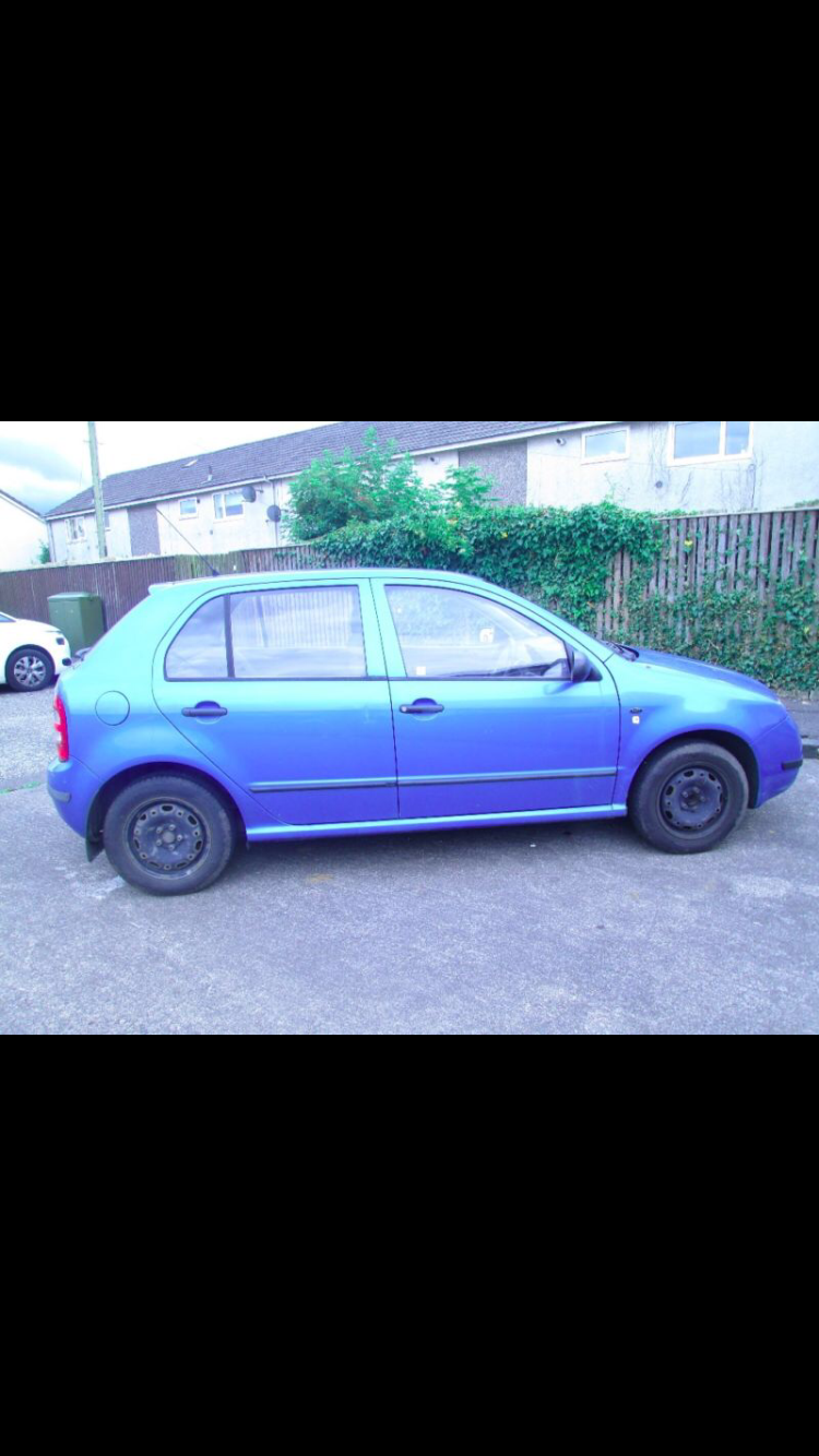

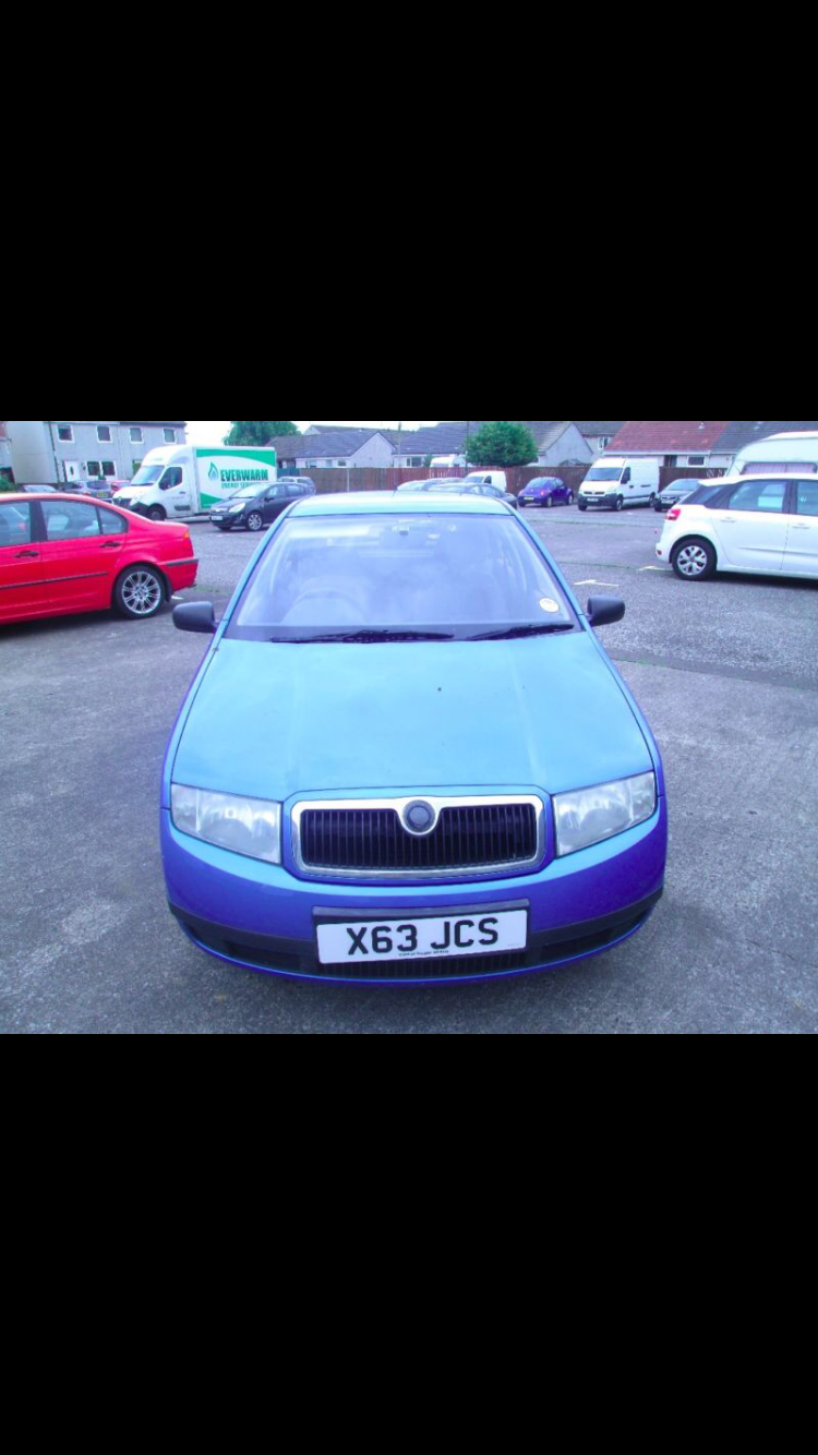

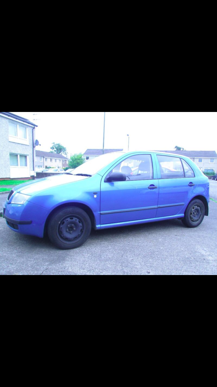

So I've started a 1.8t build.

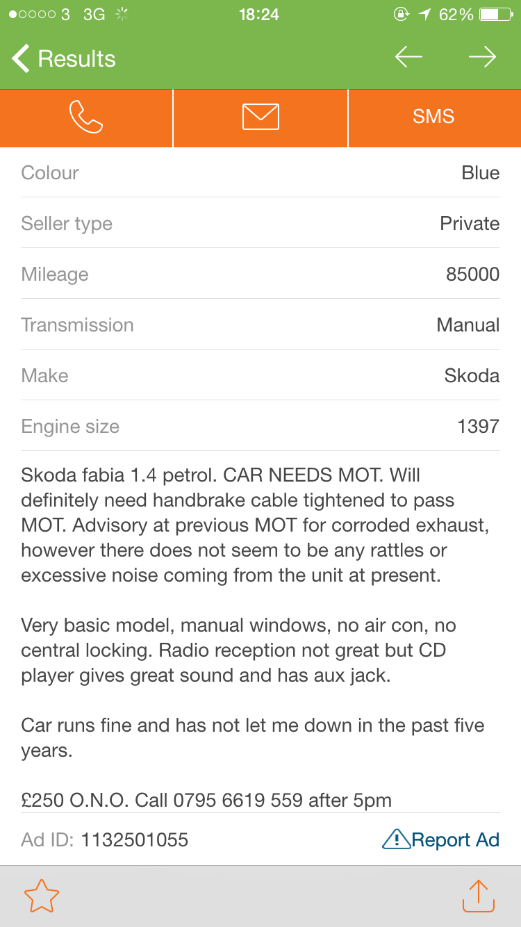

Bought a Classic X reg for £200 with no MOT but it was in not too bad nic and was quite close to me. Its a 1.4 mpi. In all honesty I don't really know everything about what i'm going to have to do, but I've wanted a project like this for a while now so I thought why not as theres a few people who have started it and I can follow them for guidance.
I'm looking forward  to it anyway and It's always fun working on a car.
