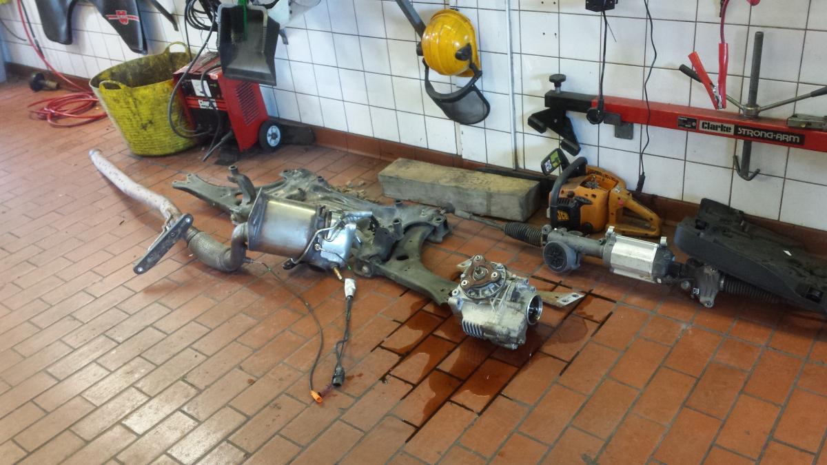

Have now, at last, got the car back. Final bill over £1100 :thumbdown: . Garage had taken a picture showing the bits they had to remove all over the workshop floor. Subframe transfer box, exhaust etc. Looked like most of the car!

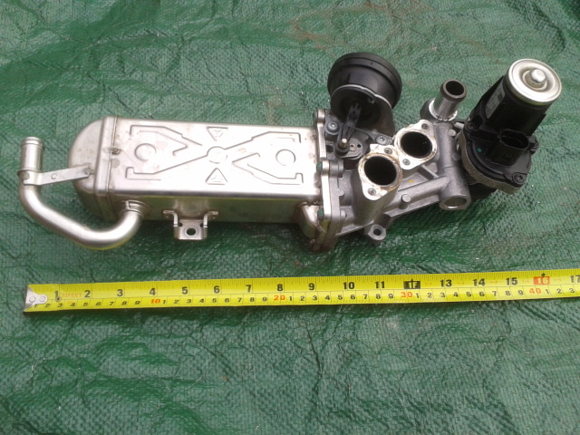

Offending item. Apparently its the servo motor (on the right) that fails.

The head of the workshop tells me they are replacing an increasing number of the EGR's on all VAG vehicles. From what he said the vans aren't to bad to change, but the cars and the 4x4 in particular are a nightmare, so if it does go, be prepared to dig deep. The new parts have been revised since my Yeti was built in 2010.

Picture  in workshop of all the bits removed
Bloody hell.
Subframe, exhaust/DPF, steering rack and transfer box all out.
If the EGR isn't actually leaking coolant or exhaust gas, then inserting a blanking plate and getting it mapped out is looking like a very favourable option if you're out of warranty!
