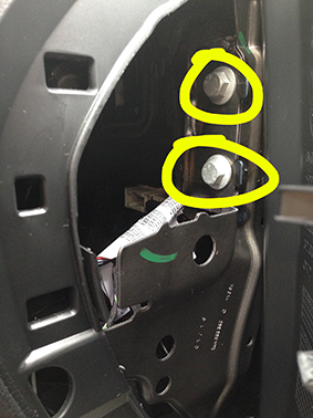

If you take the sidepanel off the dash you will find plenty of room to put everything and use one of the big bolts for the earth. The sidepanel comes off by inserting a slim lever in the side closest to you and levering it away. If you do it this way make sure you tape the socket and plug together as they can spring apart, at which point, one starts swearing.
Peter, do you mean one of these bolt heads?
Edited by Osmosis
Yes, photo came up now. Just loosen off slightly and slip the earth wire behind and do up.

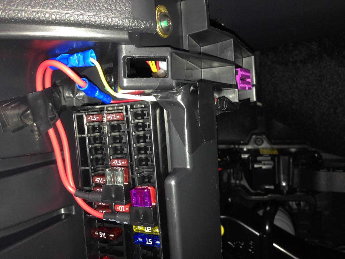

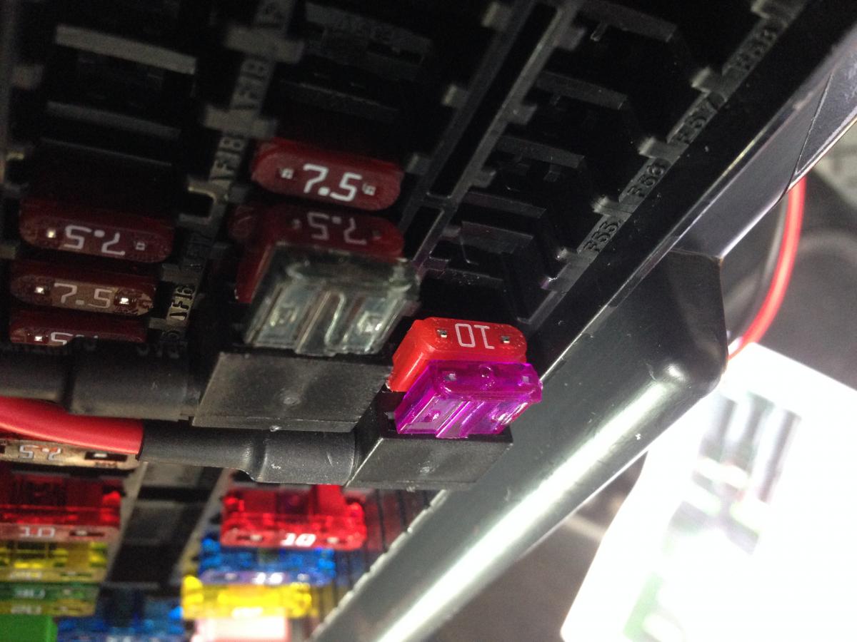

I used fuse positions 30 and 51. These are fuses that don't relate to any safety systems (p184? In the manual).
30 was used for the red switching wire with 2amp fuse.
50 was used for the yellow always live wire with 3amp fuse.
I've used add-a-circuit dual tap fuse adapters for a more professional install. Tucked away underneath and held with electrical tape to reduce any stress on them (in case vibrations were to work them loose). The fuse taps don't seem to go as firmly as a single fuse would.

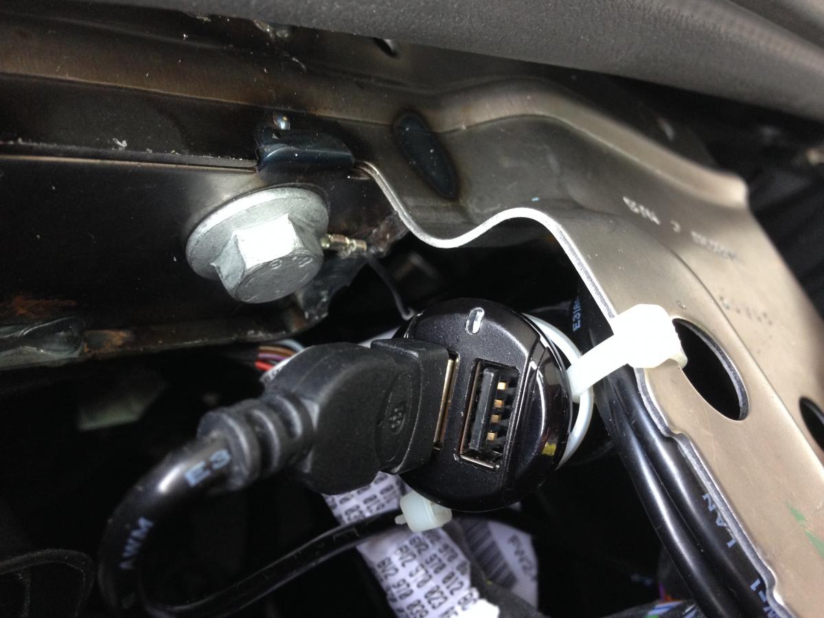

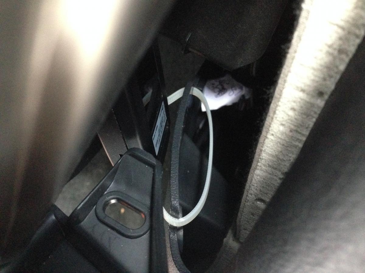

The cigarette lighter end of the Lukas is held with a cable-tie near where I've attached the black ground wire (big bolts image).
The LK-290 is set to ON, so will continue to run the dashcam until the car battery reaches 12.4 volts. At which point it will cut power to the camera.
