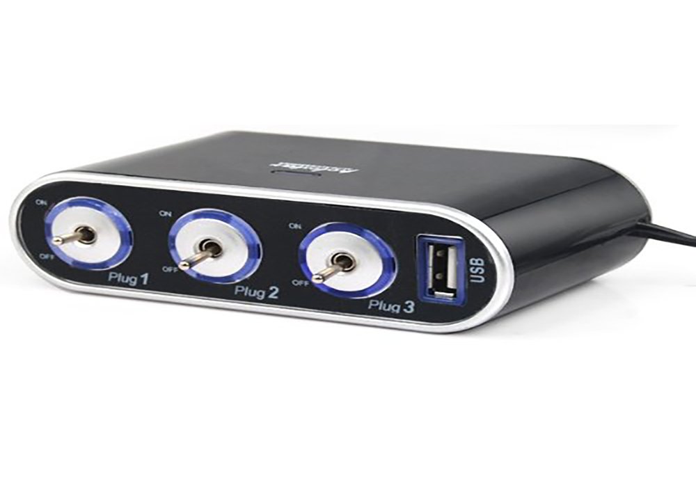

If the above advice doesn't work out you can buy an adaptor that adds a switch to make it a bit easier than constantly removing the plug
Do you know where to find one ? Thanks.
Try car accessory sections in shops or online. Here's an example from amazon.co.uk of a 3-way splitter each with individual on/off switches for £6.50:
http://www.amazon.co.uk/dp/B00YUCTVOK
