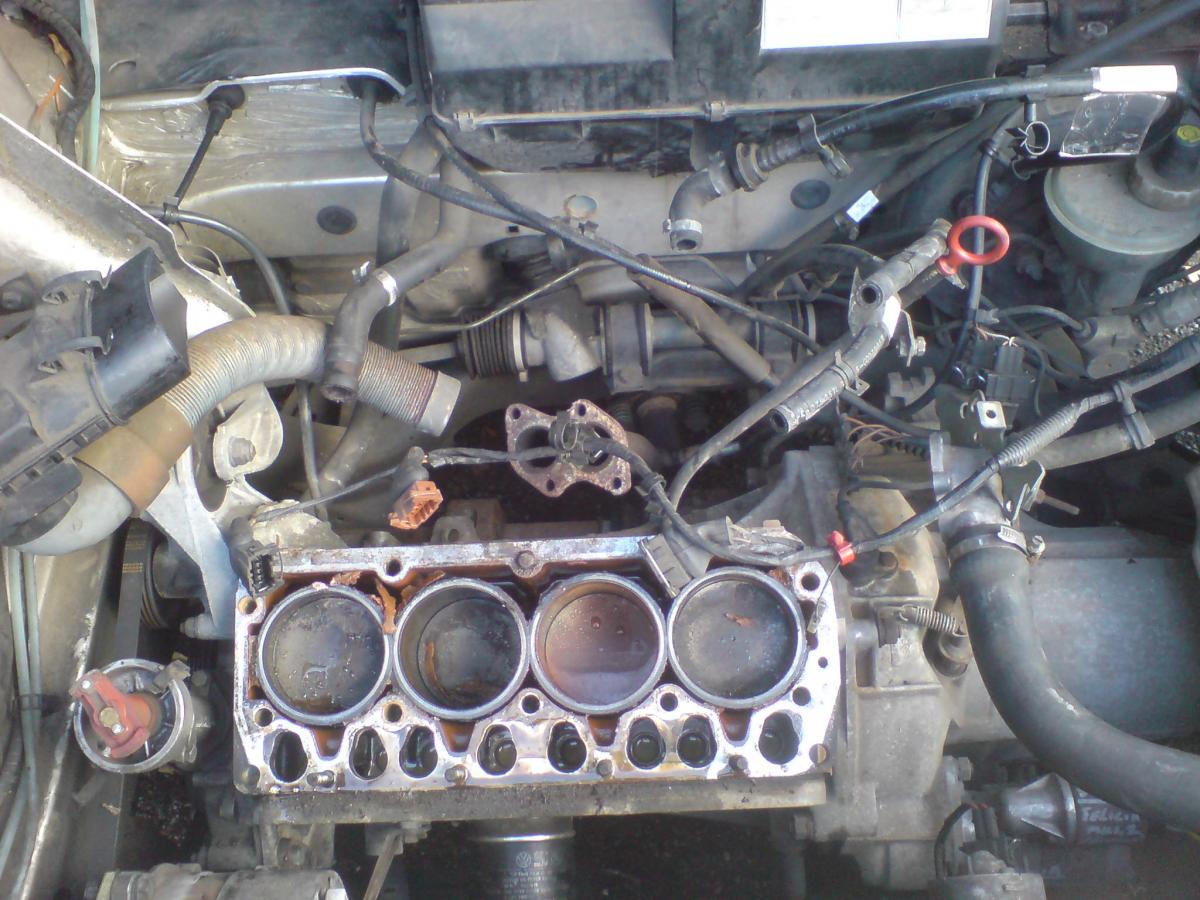

Could you take good photos of the top of each piston, please? Also photos of the fresh cleaned head on all 6 sides.

Yes of course. I'll wait until it's a bit lighter i.e. It's quite wet and dark here at the moment. I need to do the leak test anyway so that would be a good time to take the photos. I'm just waiting for all the parts distributors I emailed to come back to me.
In the meantime...here's one I took earlier.

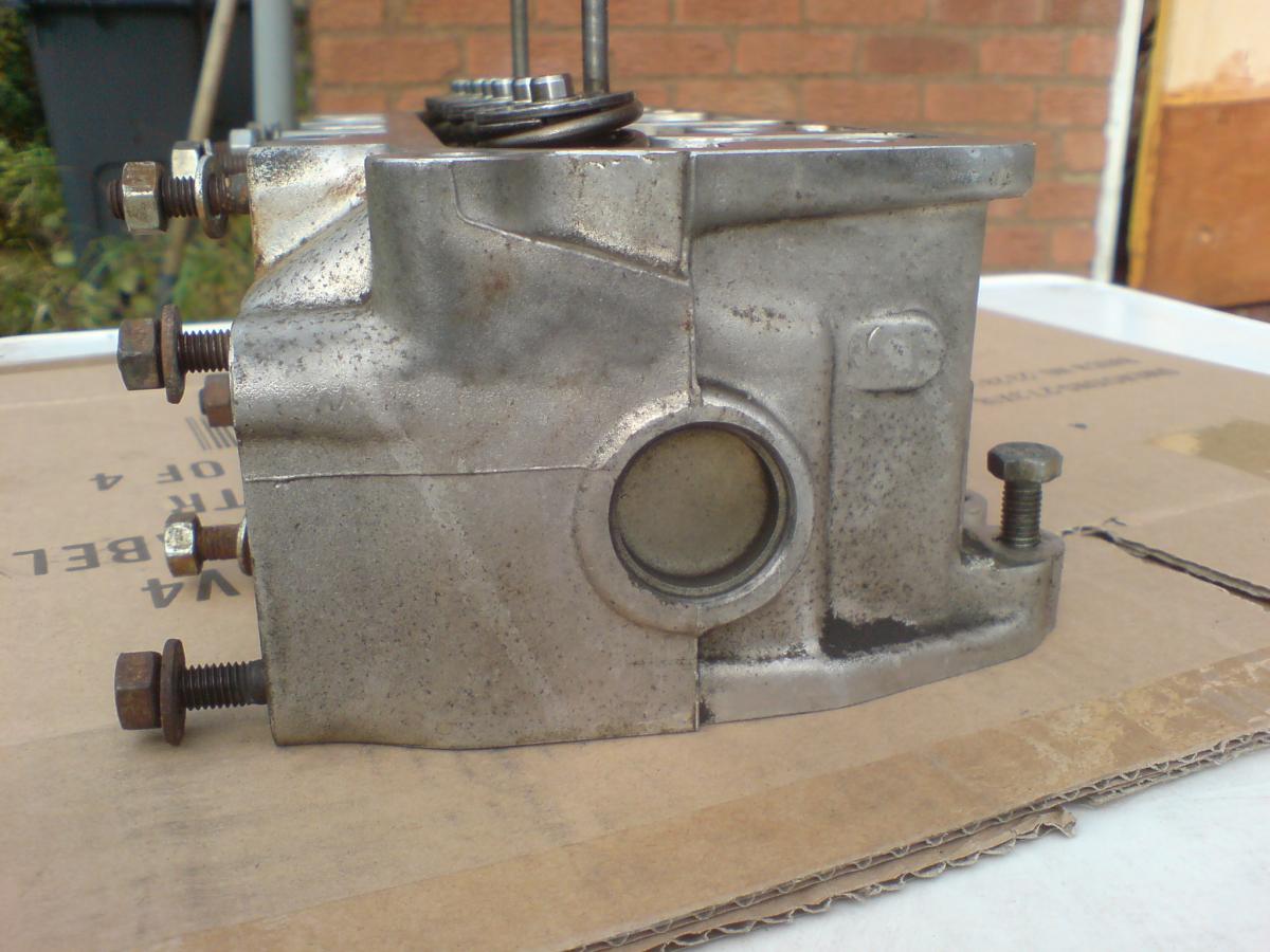

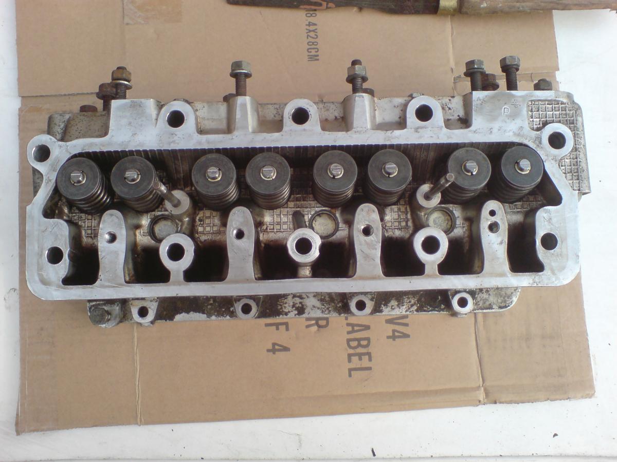

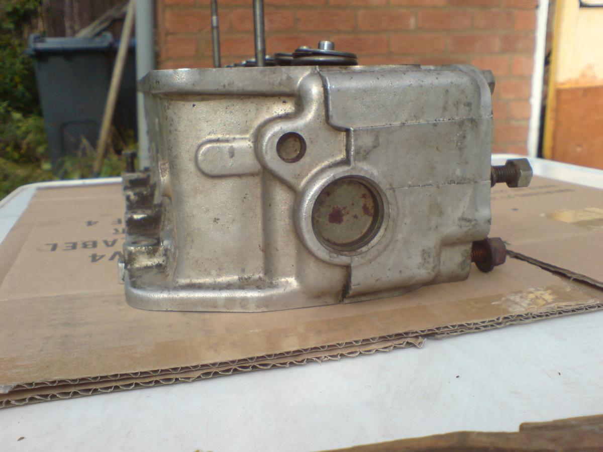

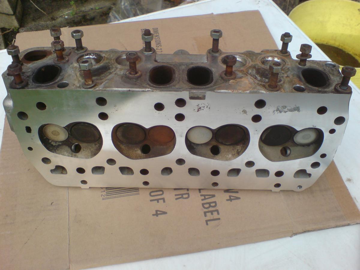

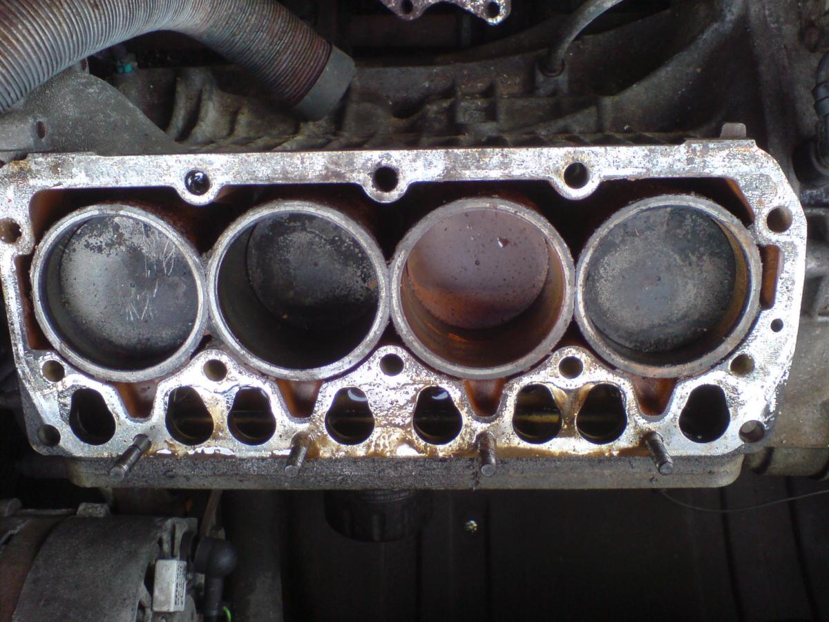

Right, first things first. Please find attached the requested photos....

For some reason I can't upload...Head_back or my leak test (combustion chambers filled with petrol for 30 mins) which passed with flying colours...once I'd replaced the spark plugs oops..

Valves leak test.

What parts are you waiting to be delivered and start assembling the head? Do you have all the tools for the job? Valve stem seals and head.
Clean the top of the block meticulously. Remove as many carbon deposits as you can from the top of the pistons. Clean all the rust from liners, block top, head, and pistons. Use WD40 for that. Blow off all debris that fell on top of the pistons. Clean the threads of head bolts with a tap. Dry the holes with air or with a strip from a rag wrapped on a stick. Cover the block to protect it from the elements.

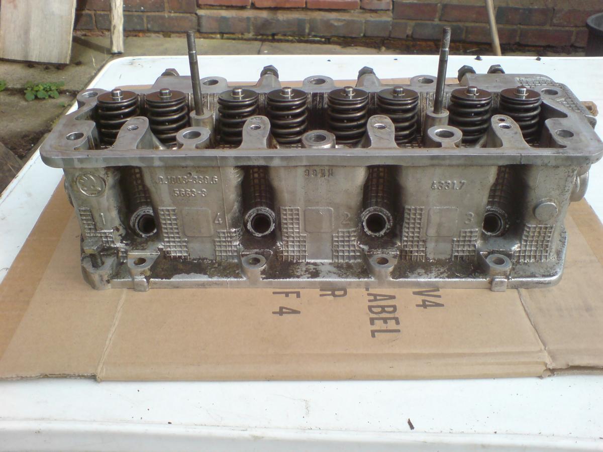

Thanks for the photos...are those the guides that fit my engine i.e. a 1.3 from April 1996?  The log book says it's a 136B engine but it looks like the same guide fits most 1.3s
There are two type of valve guides for Felicia 1.3 engines. Before 08.98 the valve stem has 8mm in diameter. After 08.98, it has 7mm. Both photos show the guides for your engine.

Thanks for confirming those are the ones in the photo. I like that they have shoulders to help with location. Some don't.
