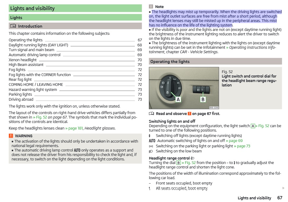

It is a known phenomenon and it is mentioned this is normal in the car user guide (at least in mine ;-) ).

A bit off topic but I like the 2nd function described in the manual:
"If the visibility is poor and the lights are not on, the brightness of the instrument lighting reduces to alert the driver to switch on the lights in due time".
This is Simply Clever ;)
