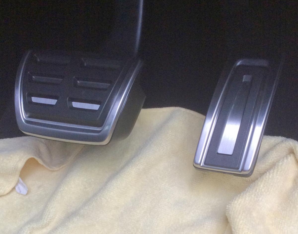

And just to add..... Finally had 5 minutes !
Looking good!
Confirmation of part number?
Looking good!
I posted a picture of the backs somewhere Si with the numbers but not sure which thread !!! Mmmm... I wonder if ive put the throttle on upside down ??? Can anyone confirm ? Might leave it anyway :-)
Going from the photo on SS I would say so yes.

Grrrr .... Leave it or turn round .... . .?
If it fits ok leave it!
Turn it round then have a well earned  :beer:
if your foot does not slip leave it. removing it will damage the rubber locating pins. If this happens then you will need to buy a new cover or bond it on, but dont use any old glue. Mark sure you use a bonding sealing agent
Did the warm water trick work.
Done... Came off ok.... It would have just bugged me. No damage apart from scalded fingers ... :-( ....
Yeah Giz beer time ! :-)
Do the Pedals just fit over the existing ones? & if so how are they secured, do they just click on??
Kind of on DSG. Brake pedal just unclip the plastic pedal and replace. Throttle is a pain. As suggested I dropped it in a bucket of boiling water first which did the trick.

Hi Gizmo, to save the search can you cover the "hot water treatment" again please.
Put some very hot water into a jug and drop the pedals covers in the water for about 30 seconds or so this will soften the rubber making fitment easier, the DSG brake pedal went on easily enough on mine without the need for hot water.
Ideally you want to wear gloves when doing this as the pedals will be bloody hot once removed from the water (obviously!)
Thanks Gizmo, just fitted mine, much easier with your advice.
