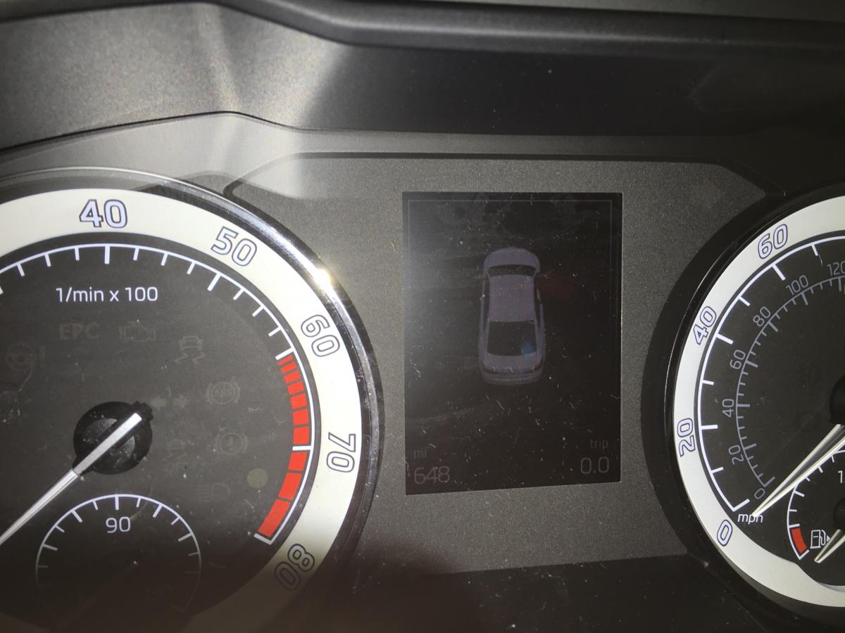

  4. How do I tell whether I have the colour maxi dot? Mine seems to be b&w.
  5. What colour are your speedo etc dials? b&w?

Having Colour Maxidot will be obvious - there different menus 'scroll' in a more snazzy fashion.

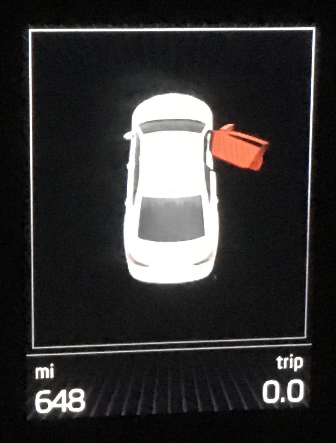

All maxidots scroll. The easiest way to tell if you have the colour maxidot is just open the door. Does it have a red open door?
L&K has an ivory background to the numbers (regardless of body/leather colour)...
