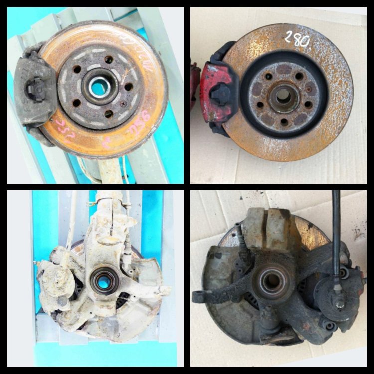

Hello! I have a Fabia 1 with 1.9 TDI engine, 256mm discs, rear drums. What about wheel bearing housing with FS3 caliper and 280 rotor from Golf IV, Toledo II and Leon 1?
I think it works, but you will need to use 15" minimum, and preferably 16", wheels.
Yes, I know that the rim must be at least 15 inches for the 280/288 disc. Unfortunately, I do not have any data on the diameter of the toledo / golf / leon shock absorber. I also wonder how it will be with the hub and bearing ...
  • Sponsor
Would fit an Octavia, but not a Fabia, I believe.
