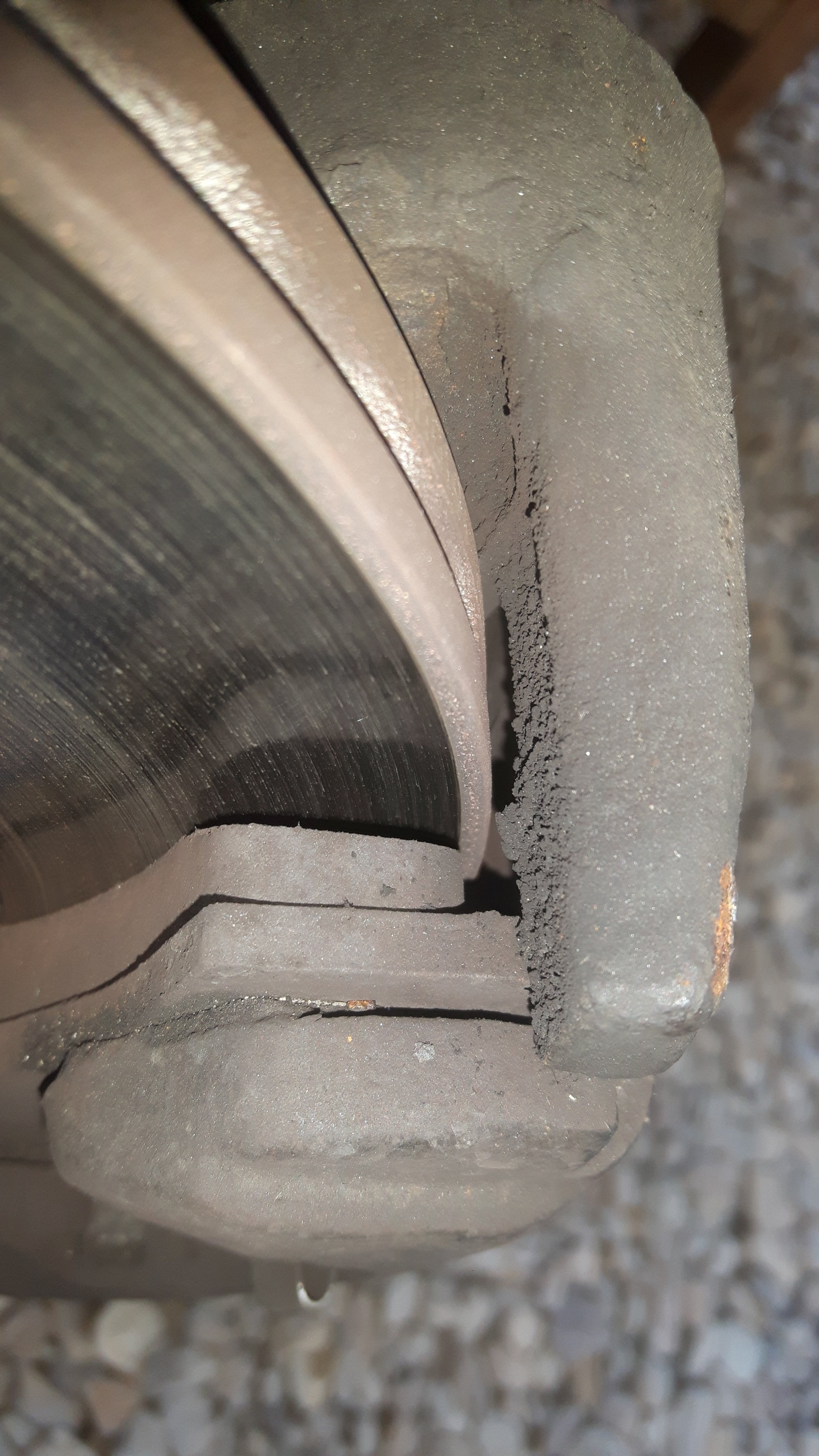

This is the truth of the matter. Here's a photo of the FS2 set-up with 239mm disc and corresponding carrier part of the wheel bearing housing:
The gap is less than 4mm.
A 256mm disc won't fit.
crap 😞 then ill stick with the 239 system.the carrier change wont worth it
thanks for checking
