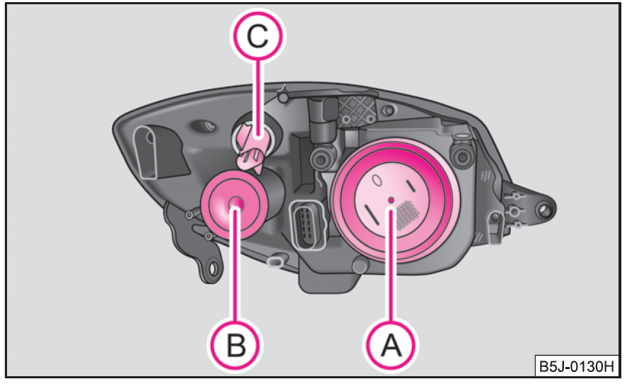

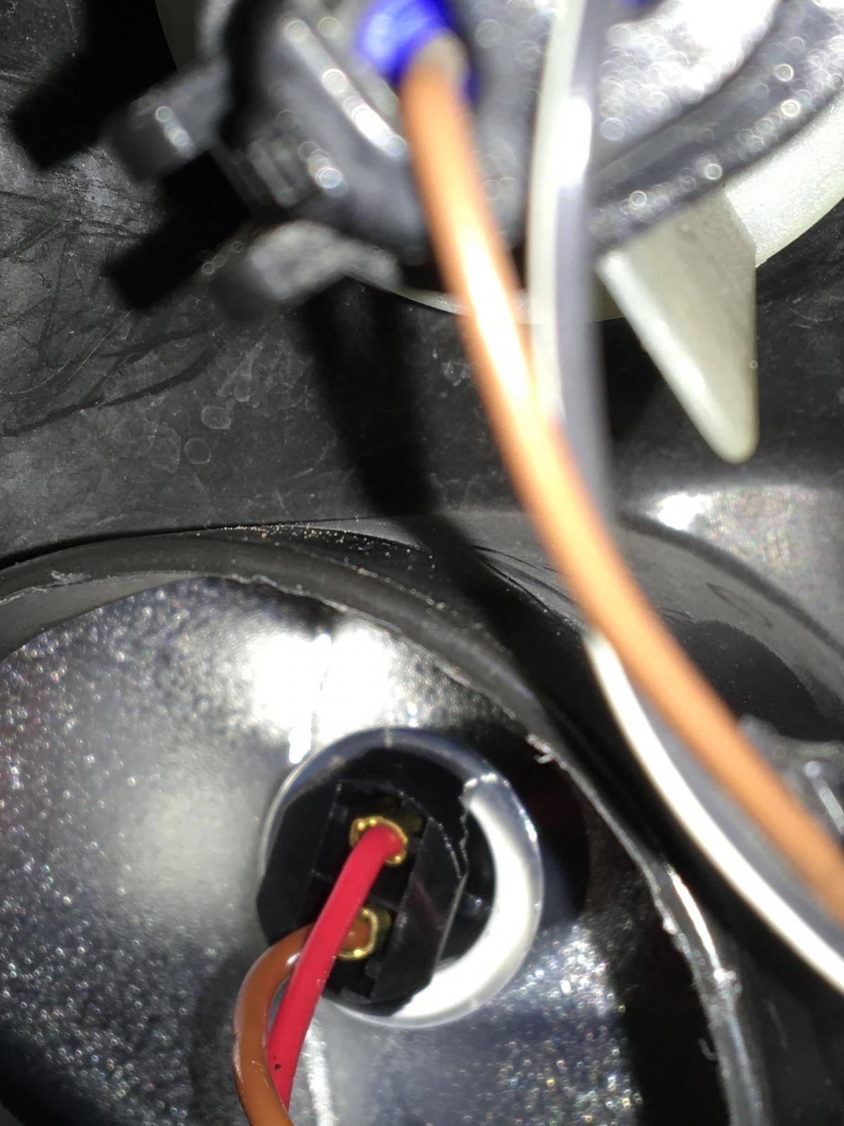

Here is the sidelight bulb. I still cannot change it as it is very tight.
The sidelight/parking light is B (W5W bulb)
The reason I know my license lights used to work without turning the lights is because I tapped my rear camera to them and it worked perfectly.

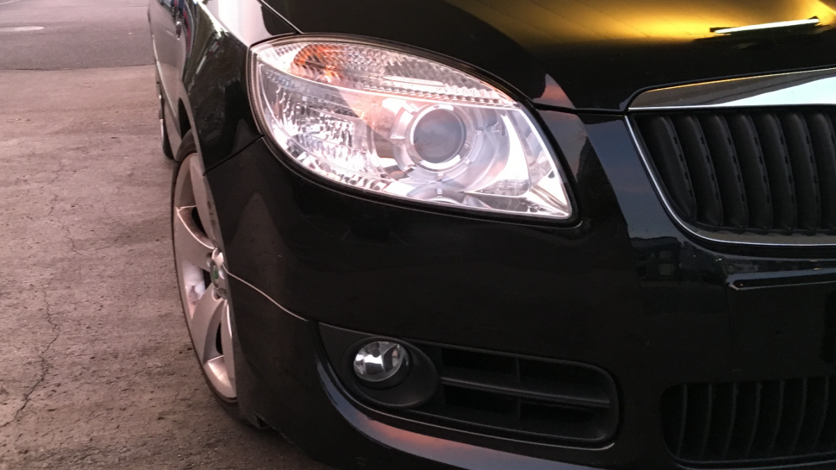

And for info here is a pic. It's got the round fog lights.
Edited by Yepecece
So. Which part are you thinking is a DRL on that car mate?
Or are you looking to put drls on?
I'm not sure if it was a default DLR but they would turn on! I believe the low beams were acting as DLR because when I put the switch in the middle position the lights would become dimmer.
The main beam (circular hazy lookin bit) is a H7 55w bulb. It does both low and high beam using a solonoid and a shutter system, but is constantly 55w. Theres no other bulbs in there.
The outter bits are the sidelights. Theyll come on thwn the switch is in the middle, along with the rear lights and the numberplate lights.
The bottoms ones on the bumper are just fogs
I'm struggling with this one, as far as I can see and know your car does not have DRL'S
What you have described is you have been running around with your side lights on.
From what I can make out from your responses they where coming on with the ignition even if the switch was in the 'off' position. There is no way, in my mind the bulbs would dim when the switch was turned to 'sidelights'.
