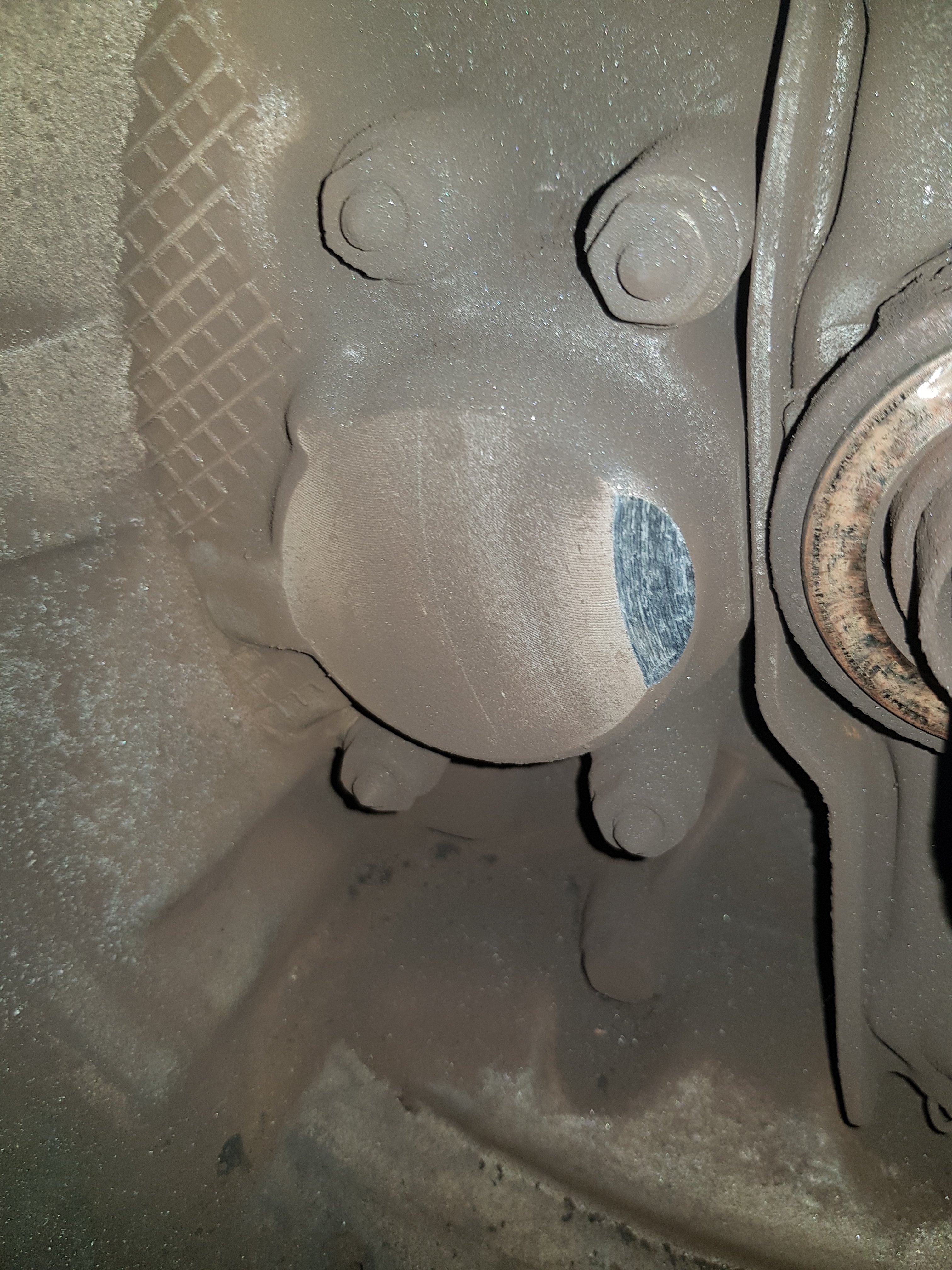

Yep its a 5 speed box, I asked cause i noticed this inside my gearbox and have no clue what could cause it.

Coverplate failing! - The bit "eroded" is a bit that sticks out beyond the clutch arm. Do you still have access to the old cover plate?
Presuming you've changed the cover plate you may have ducked a bullet

Yeah still got all the old parts so can take more pictures if need be, just waiting on new clutch kit being delivered.

Ah indeed - If your cover plate starts to fail then less spring force is applied to the cover plate/friciton plate/flywheel "sandwich" - this would cause slip under load. Think you have a clue in the bit of metal machined out of your gearbox
[EDIT[Looking at the latest post in the other  thread you'd need really really bad crankshaft float to cause this wear and float woudn't cause clutch slip.
