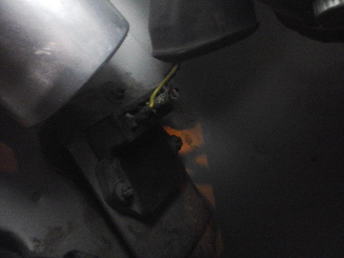

Hi. Does anyone know what is this in the picture its below my ignition coil on my skoda felicia 1.3lx carb model
I'm guessing it's the ballast resistor.
It's an ignition amplifier. Basically, it's the brains of the ignition system. It takes the pulse from the hall sender on the distributor and uses it to control the the coil so you get the right spark at the right time.

oh really thanks guy its been a long time been saying to myself whats that?? :)
