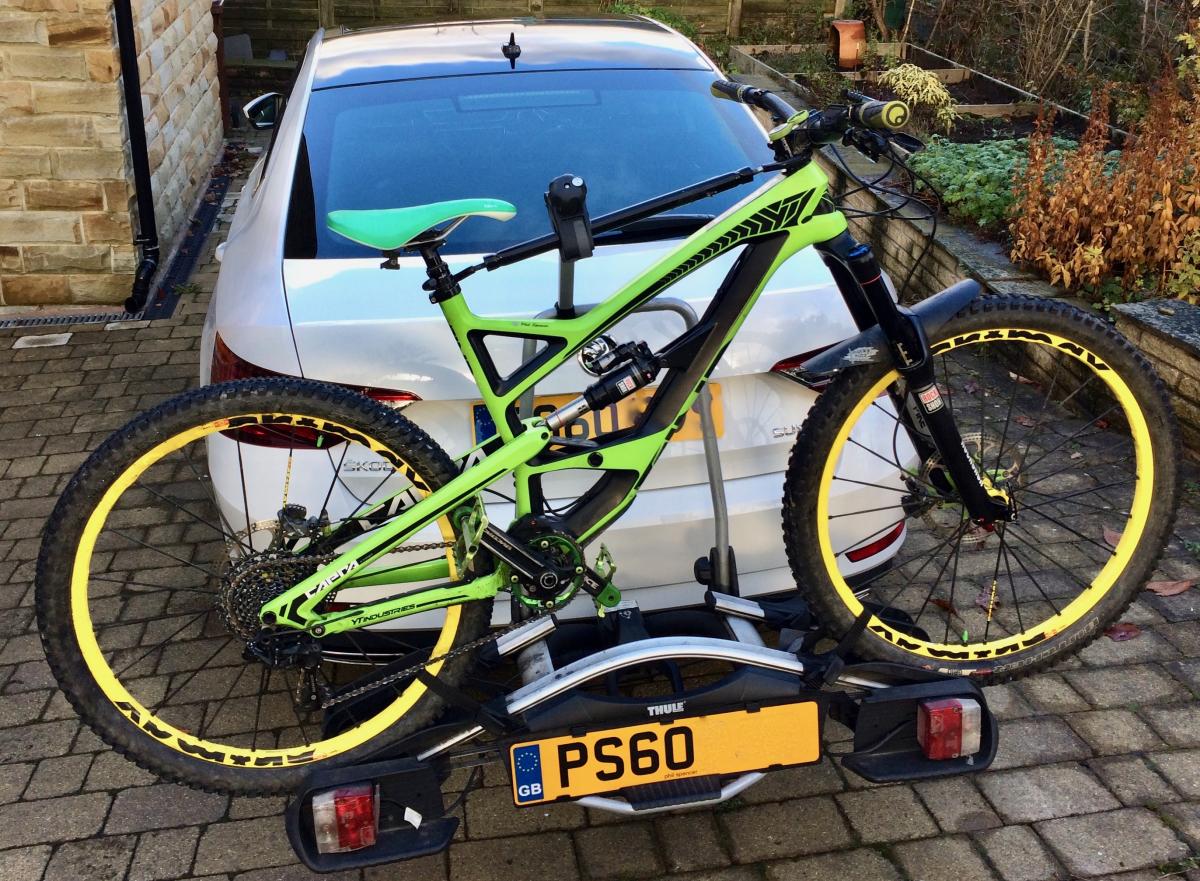

post-61647-0-02783600-1478272165_thumb.jpg  Thule 2 bike carrier on factory fit tow bar. Factory fitted bar well worth the money.
