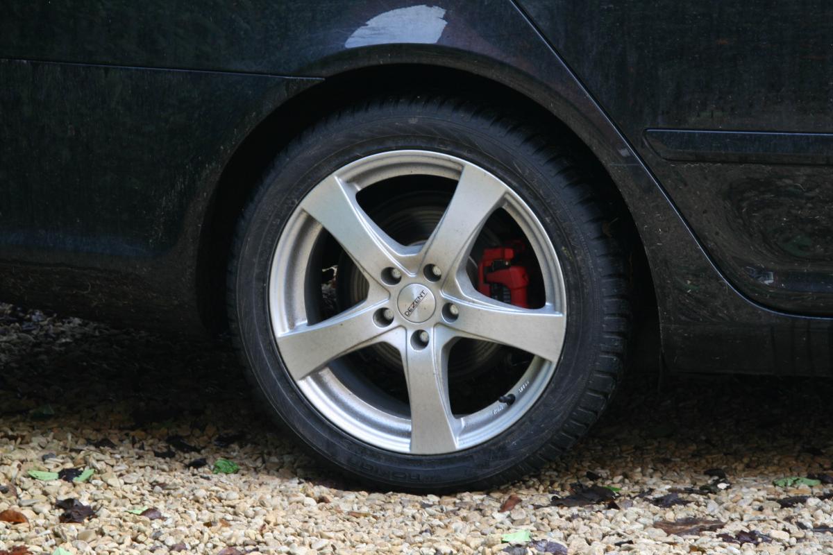

I have the same car. My winter tyres are 225/45-17s on 7.5x17 ET45 alloy wheels. Actually prefer to drive the car on its winter wheels than on the summer set as it then has a better ride and is quieter.
