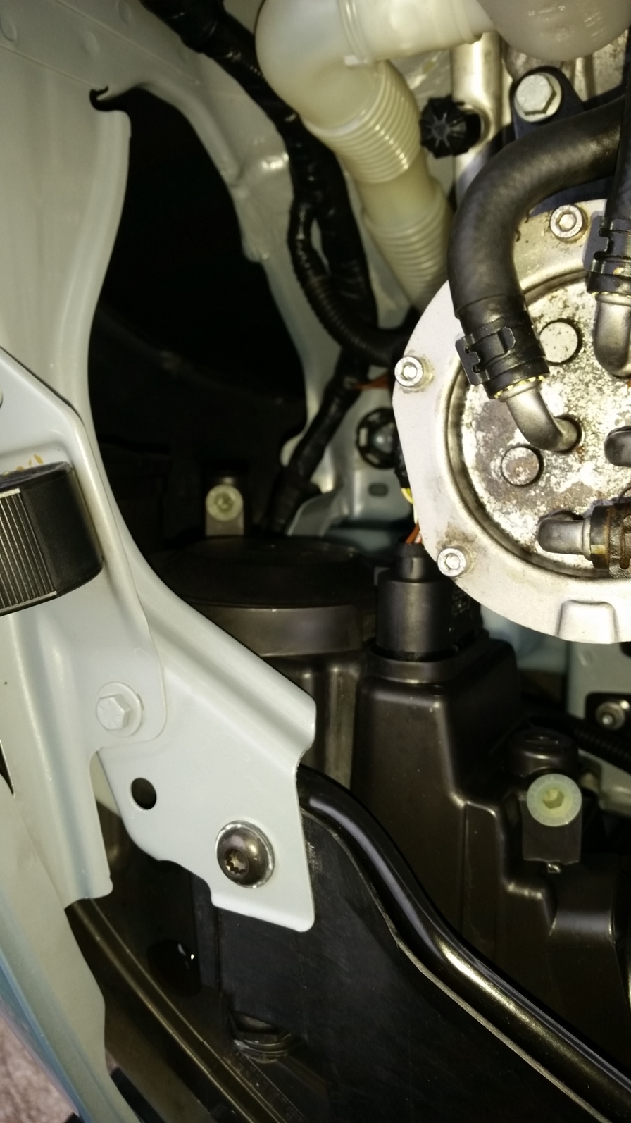

Are these screws towards the wing for the up down adjustment I take it?
I will hook up to Vagcom while adjusting, do anyone know the specific path (central electric/Xenon range?)

A guy adjusted mine without reference to Vagcom/VCDS and it worked fine. Still perfect 6 months later.

You can adjust them but should be done with the beam setter..

Some say you cannot do it without VCDS because you have to teach the level sensors new headlight positions, but I`m not sure about it.
VCDS is necessary to turn off the adaptive functionality during beam setting - it sets the headlamp position in the nominal 'centre' position. This allows you to set the optimum alignment so that the adaptive system can work to its best.
