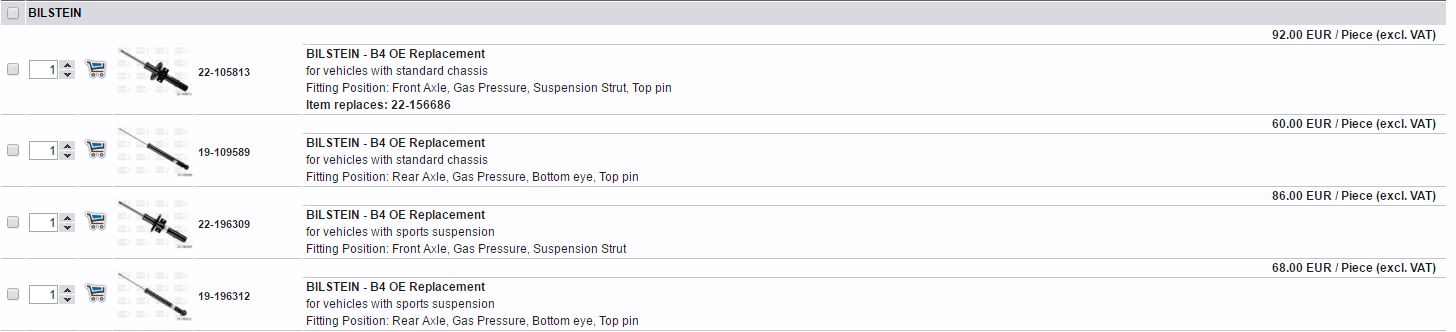

Oops, double post! Very sorry. I've just had a look on the Bilstein online catalogue and they list several versions of the B4s - ones for use with sports suspension and other for normal springs. Which do I go for? (I've also double-checked the Pro-Kit and they're spot on - good find, freaky)
http://www.bilstein.com/sg/products/search-service/online-catalogue/
Edited by GeneralDogsbody
Since you're fitting shorter sports springs you should fit the shocks optimised for them.
Ah blast! The set I found are the standard B4s - back to the drawing board......
