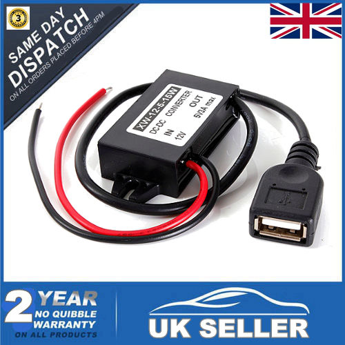

I made a box similar to above to go under the heater controls. Ran live from a piggyback fuse in the dash-end main fuse box, ran earth to the nearest bolt/screw into the framework. Fitted a switch I had lying around with an LED... The USB bucks are rated 5V 3A each.
http://www.ebay.co.uk/sch/sis.html?_nkw=ADD+A+CIRCUIT-+FUSE+TAP+-+PIGGYBACK+FUSE+-+STANDARD+FUSE+2+YR+GUARANTEE+%3A+AFH50&_id=251650492205&&_trksid=p2057872.m2749.l2658
http://www.ebay.co.uk/sch/sis.html?_nkw=1pc+5V+USB+DC+7V-24V+to+5V+3A+Step+Down+Buck+KIS3R33S+Module+Arduino+LM2596&_id=161431330648&&_trksid=p2057872.m2749.l2658

I have used these - they are very flimsy and a great deal cheaper if bought from china on ebay - but I wouldnt recommend it. I use an adapter that plugs into cigar socket and provides...another cigar socket surrounded by 4x USB sockets. I have been tempted myslf to borrow 12V from the back of the radio and fit a usb socket in one of the blank switch sockets e.g. heated rear screen. Again ebay would provide the required 12v to 5v hardware for pennies.
