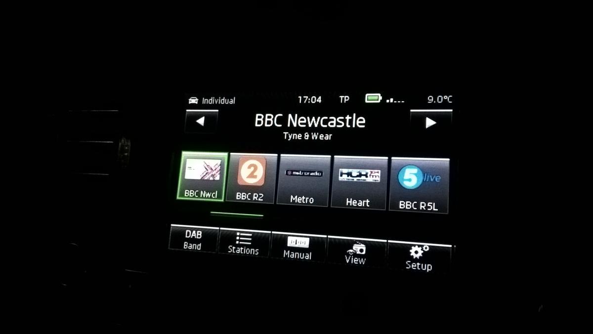

I have now uploaded the logos, however they seem a bit small.
The logo on the third preset can't be read it is too small.
Can these be re sized?
