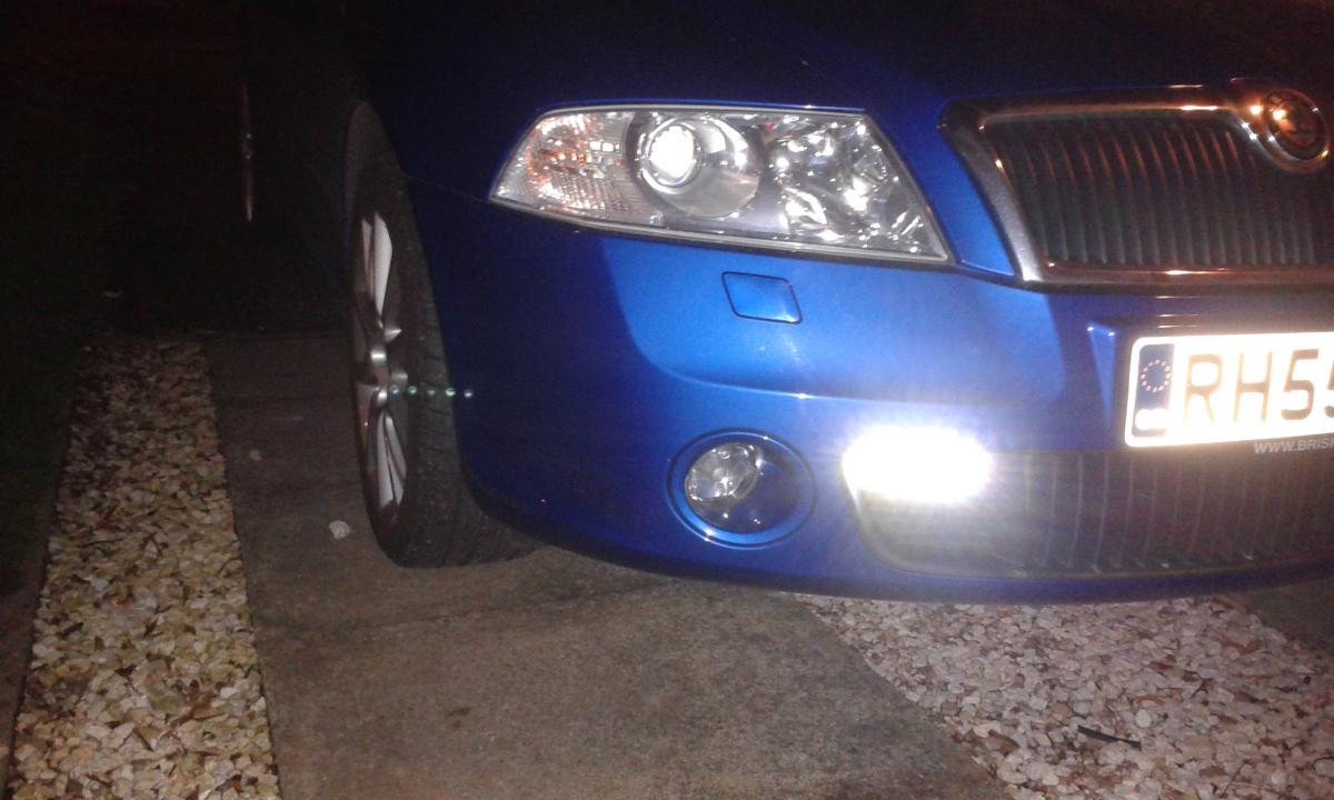

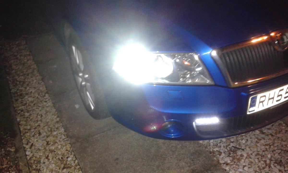

These are the DRL's, you can't really see the Tie Wraps unless you look hard.
Not yet fully wired up, waiting for a Piggy Back Fuse.

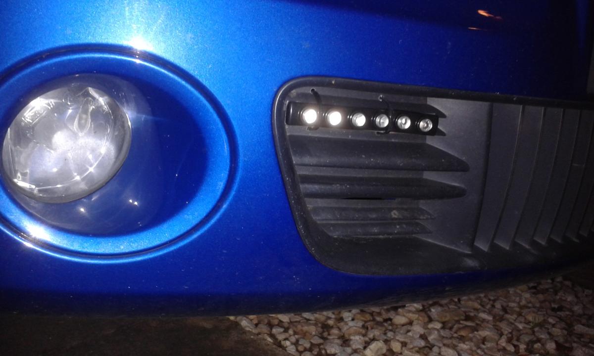

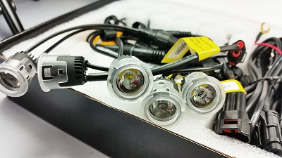

I purchased these bits
2PCS Waterproof Daytime Running Light 8 LED Car DRL Lamp Super Bright White 12V
DRL Daytime Running Light Relay Harness Auto Car Control On/Off Switch 12V New
Genuine AMP/Tyco/TE 2 Way Superseal Electrical Waterproof Connector kit
2x 12/24V Add A Circuit Standard Blade Fuse Boxes Holder ATO ATC Piggy Back Tap
All from Ebay
Just waiting for the Piggy Back Fuse so I can plug it all in.

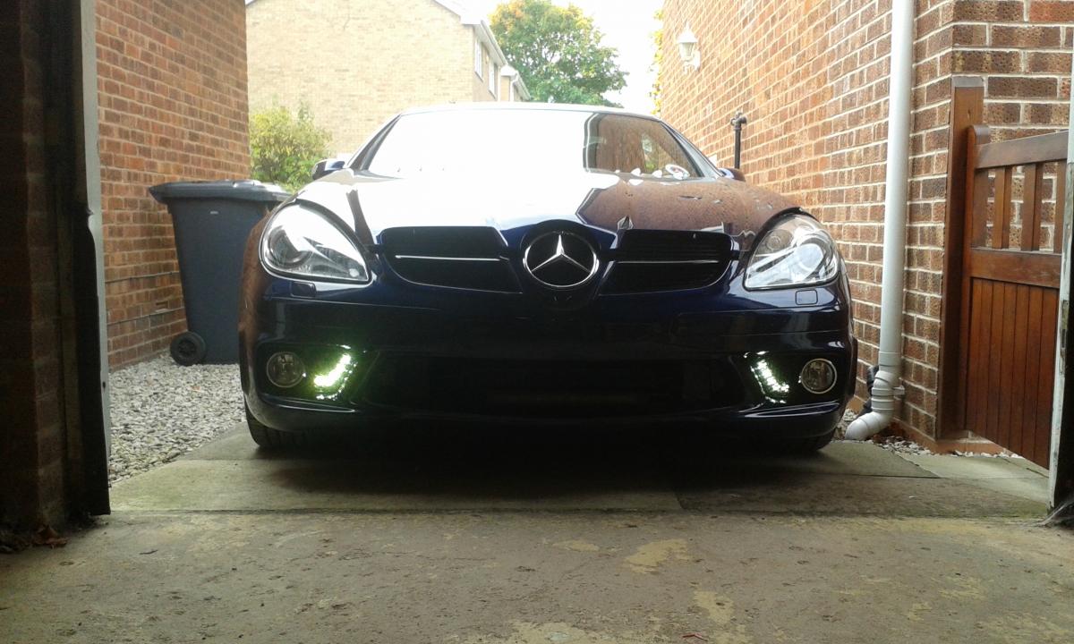

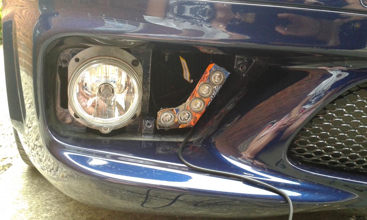

I made some 'Stealth' DRL's for my other Car, the picture shows a Cardboard Mock-up with individual LED's, these are then covered by a Grill.
The Cardboard is now Stainless Steel Fabricated to suit.

Where are you wiring these to??? if they are going to be DRL's then won't your fog lights be on too?
They are wire to a fuse when the Ignition is live using the Piggy Back Fuse. The DRL Unit then has a wire to the side lamp which will then Dim the DRL's when the Lights are on.
Nothing to do with the Fogs.
All done and wired up, they come on with the Ignition Key at Position 2 (Start up)
