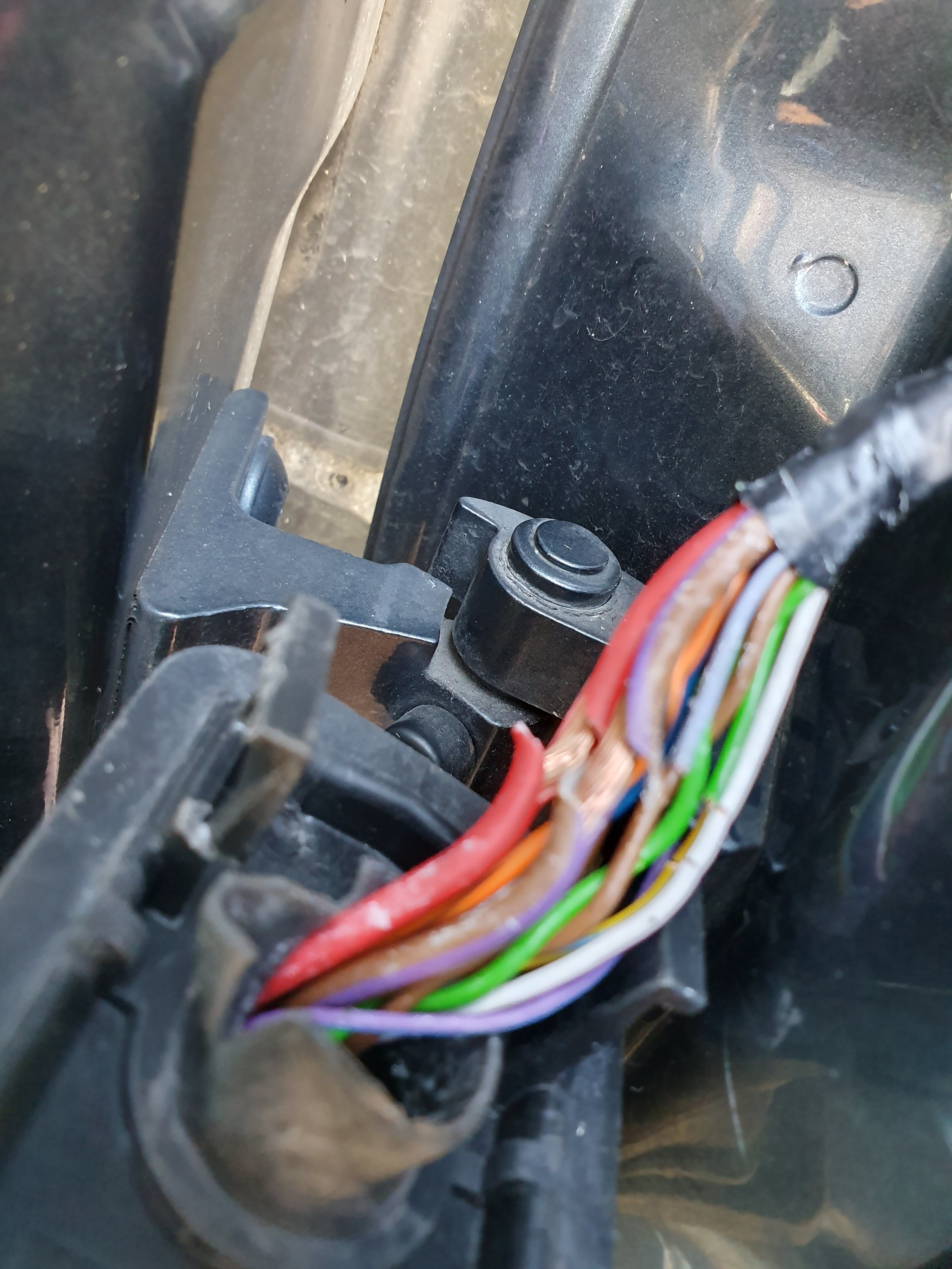

Thanks matthewg. Just had a look and sure enough 3 wires broken (green, yellow/blue, white/purple) and a thick red wire badly frayed. See pic. can't see other ends. Short of cutting the rubber shroud off entirely, i dont see how i can fix it. Could I buy a new loom and install it?
I brought my car to an auto electrician and he sorted them out as there just isn't enough room for to fix it. I still have issues to this day. Airbag light on constantly. Will have to sort it before my next NCT (MOT)
I have problems with my door wiring also, but it's funny, as it's the passenger door window that I can't control from the drivers side door controls. Also, drivers door speaker no longer works. PITA as I drive a taxi, and when someone comes up to the passenger window, I can't open it.
I would make an attempt at a repair, but access to the wiring is difficult, as it's behind that large rubber grommet, and it's impossible to open.
I have the same problem, also used as a taxi.. had it in the auto electricians today. Couldn't find the problem. Was very happy to take the  £40 diagnostic
It's most likely broken cables in the drivers door, between the door and the body of the car, in that plastic cover.

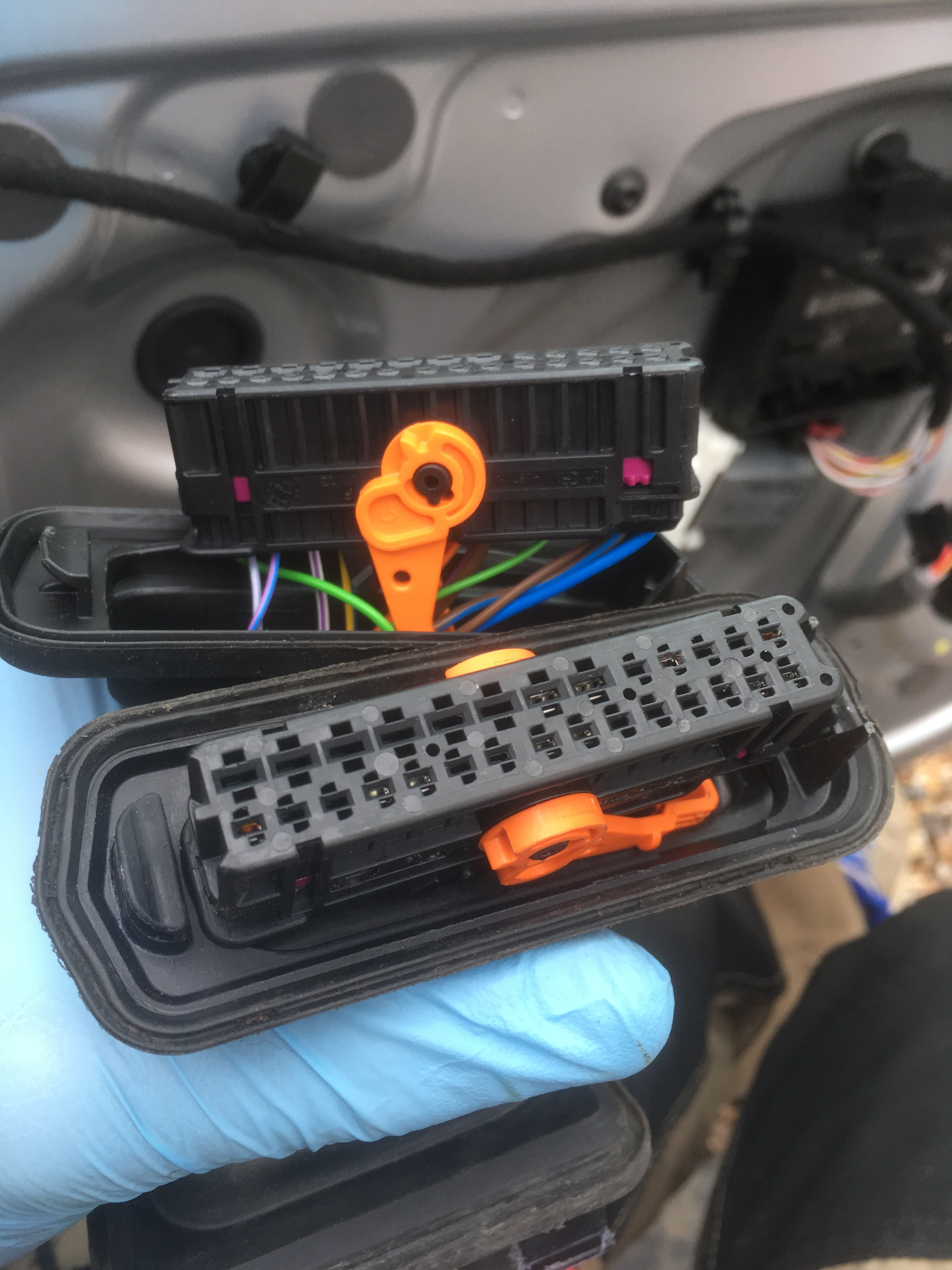

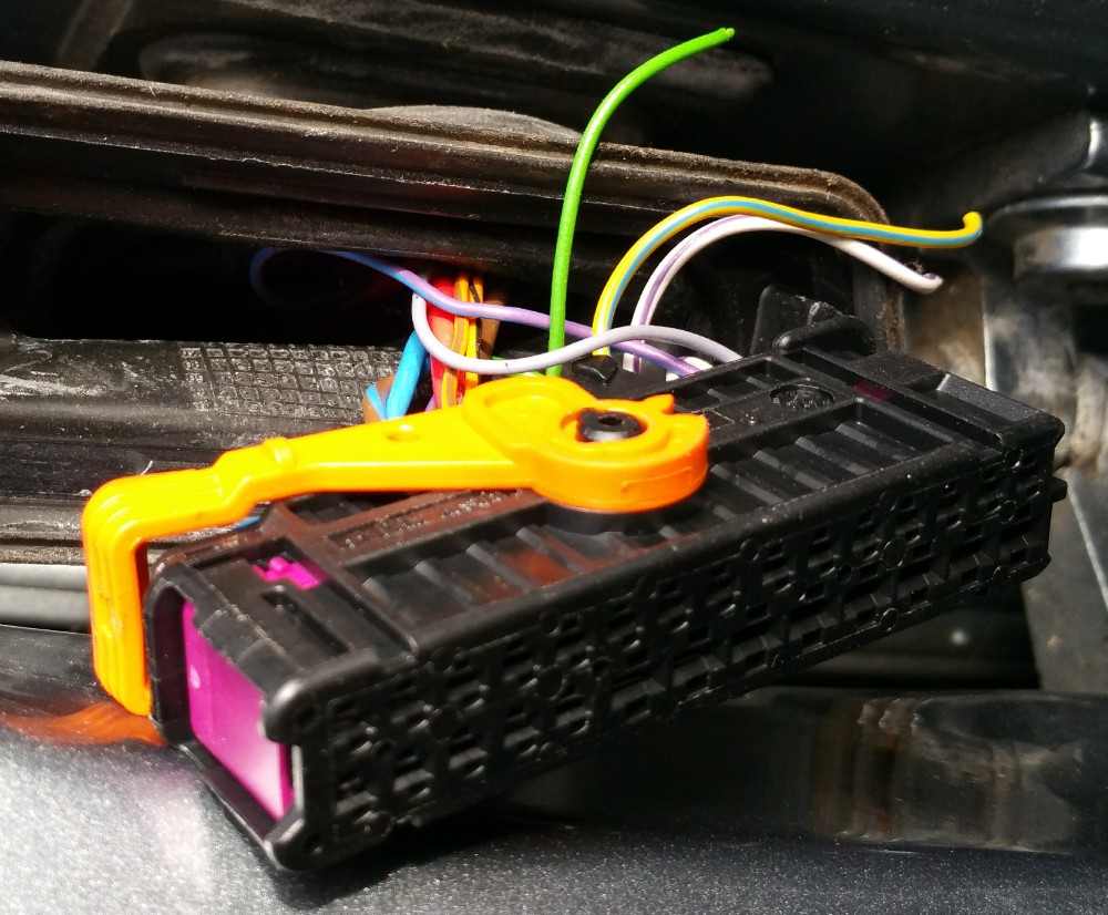

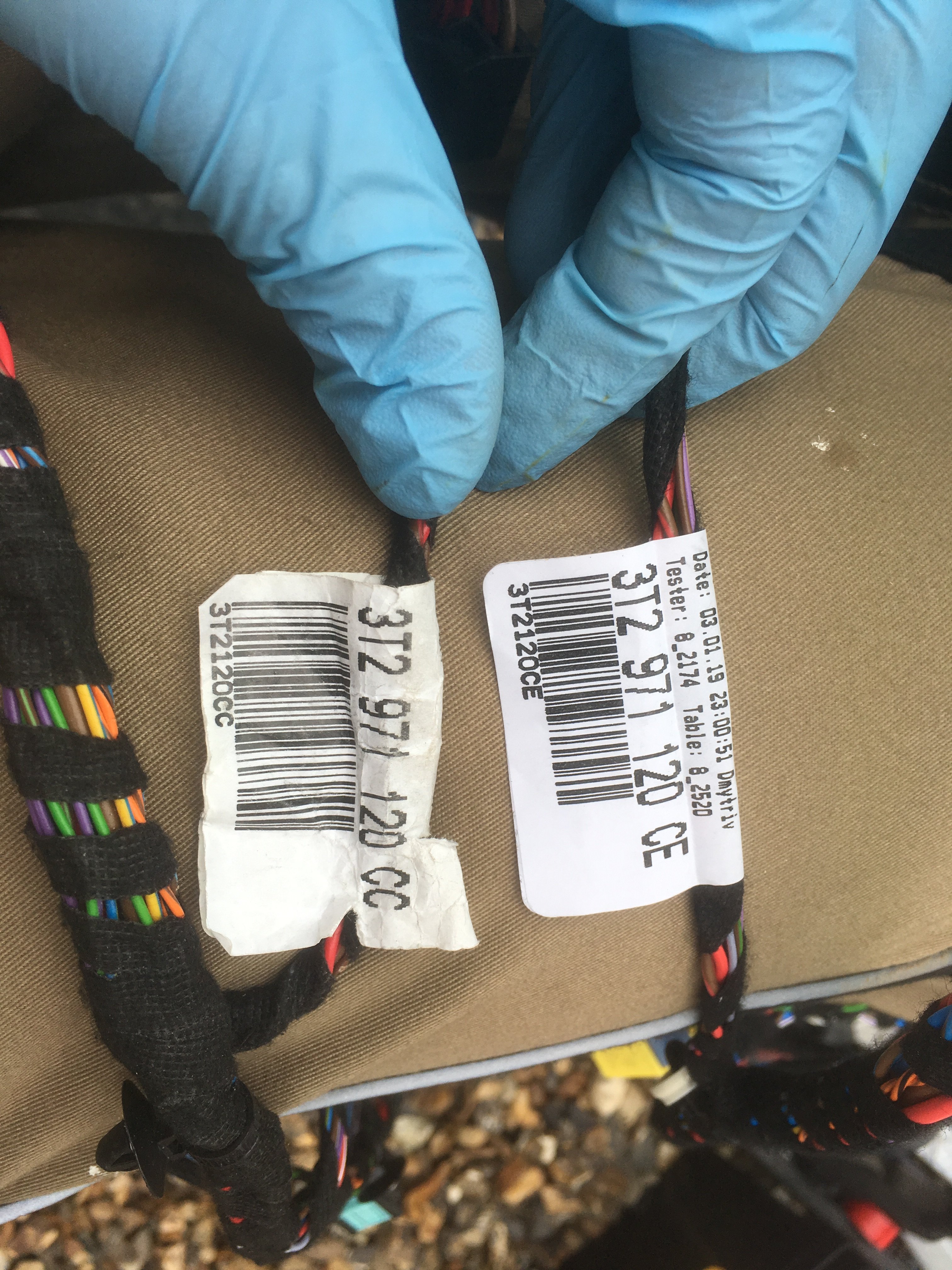

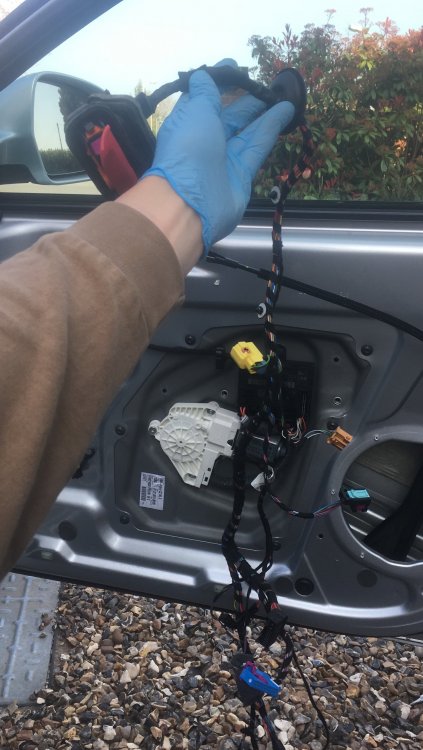

Hi all, I have the same issue, rear drivers side door not locking, or anything working on it for that matter. After reading this I checked the drivers side door loom and sure enough one snapped green thin wire and other wires with copper exposed. I tried to solder the cable back together but don’t think I did a good job as the back door still isn’t working. Can anyone confirm if the thin green cable has an effect on the locking? Skoda want £124 for a replacement loom no. 3T2971120CE
Whatever might be wrong with your back door, the wiring loom on your driver's door is definitely done for and needs replacement. Sort that out first before you go guessing about the back one.
The back door thing happened me and it was the loom in the drivers door. Once that was fixed the back door worked perfectly
Cheers guys, will order the new loom tomorrow
Drivers loom replaced with modified version and everything works! The modified CE version seems to have longer cables... hope this lasts a while!

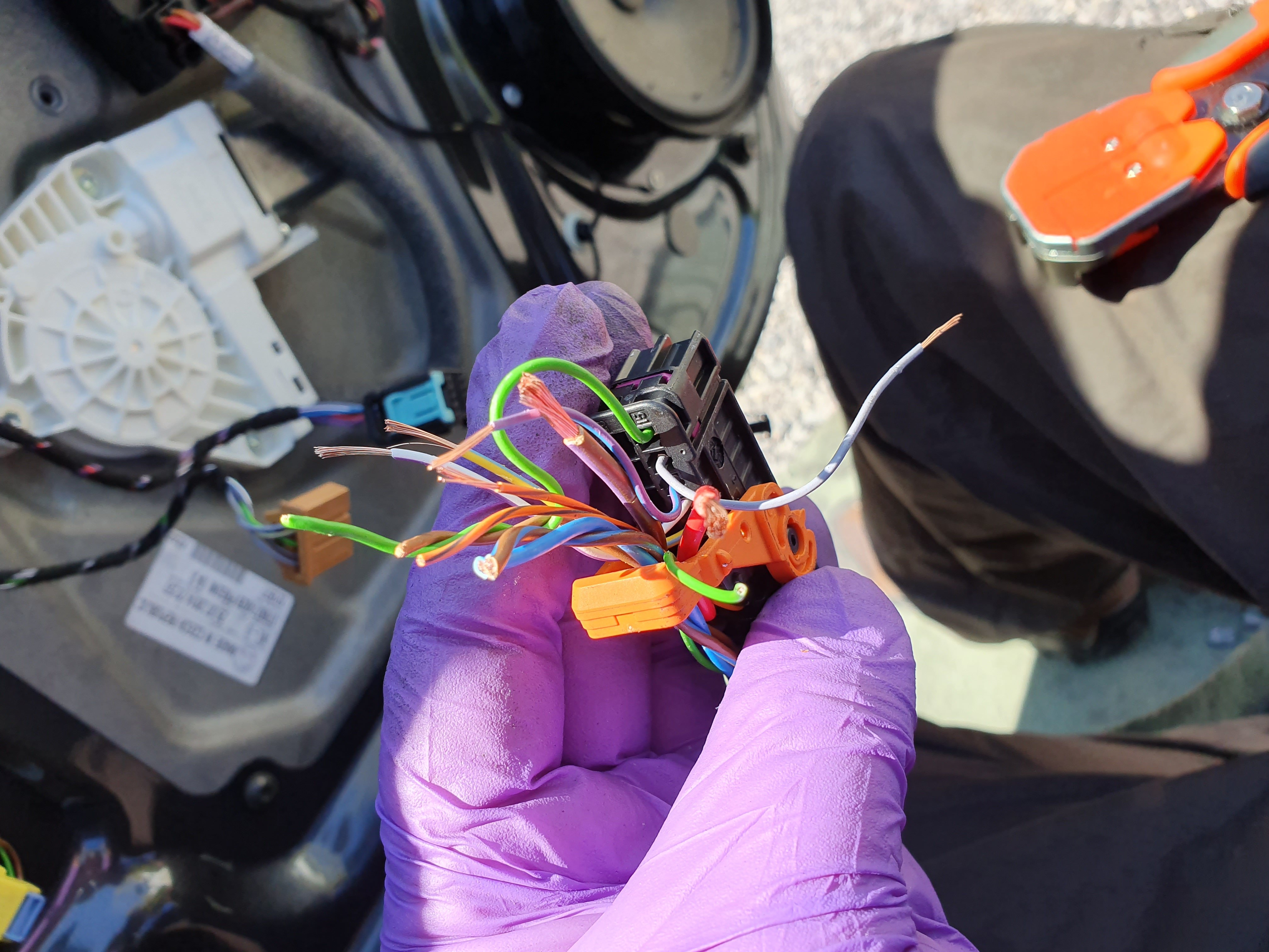

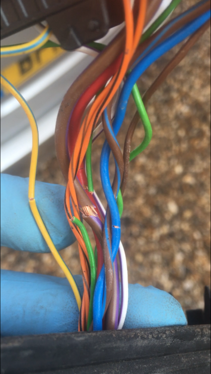

I had the same with my rear door, first it wouldn't lock then the window wouldn't work, turns out it's the drivers door wire in the rubber gaiter , So I cut the whole plug off I spliced and soldered mine with  extra pieces of wire, took me about 4 hours, a right nuisance . 3 wires snapped and about 5 on the verge of snapping, the remainder  nearly all had  cracked insulation.   I think skoda need to change their wire supplier! I'm surprised the pos and neg didn't short out as they were right next to each other without insulation as you can see
Edited by terrytowelling
Just done mine today after stripping the rear door down to then find this thread.....
I did mine in place one wire at a time extending them all by about 2 inches
I too stripped down the rear door until I saw this thread. All the time wondering why would the wire go faulty on a hardly used door lol The rubber boot looks  really nice but just hides some ordinary tightly stretched wires
Just cut the plug off where the fraying is and solder about 20 cm wires onto the ones  coming out of the rubber thing then that gives you enough room to attach the other ends to the plug  ( use shrink wrap tubing to cover the joins ), then when that's done you can pull through any slack into the door. I had a old washing machine loom hanging about in the garage which fortunately has many different coloured wires so I used these
