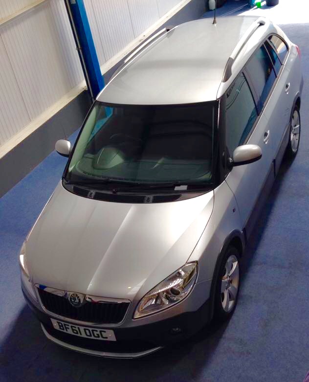

My Fabia Scout 1.6 CR is up for sale ;)
I've had it for nearly a year and it has been faultless. Great car, nice to drive and returning 55mpg easy. I had been doing 600 miles a week and it fitted the bill perfectly, comfy and cruise control etc are a blessing.
