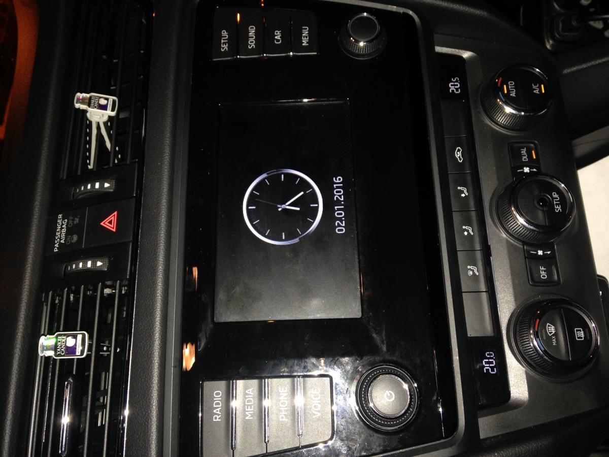

Hi all. What head unit is this in my Octavia and how do I remove it?! There's a wee bit of black trim underneath that comes off but all that covers is what looks like a chip board lol
Looks like a Bolero head unit.

Cheers :) the Amundsen looks similar but removing that looks easier lol

Have a search on this forum. Someone (andyvee?) tried to retrofit a Columbus about 2 years ago, I don't think it was successful but I remember there being photos etc.
From memory the screen has a void behind it as the brains are in the glovebox.
These headunits are very integrated into the cars operation e.g. tyre pressures, phone, locking, lighting etc. so I think you'll struggle without it.
You can fit sat nav to the Bolero for about £400 if that's what you are after.
Just search vw mib sat nav on Ebay.
