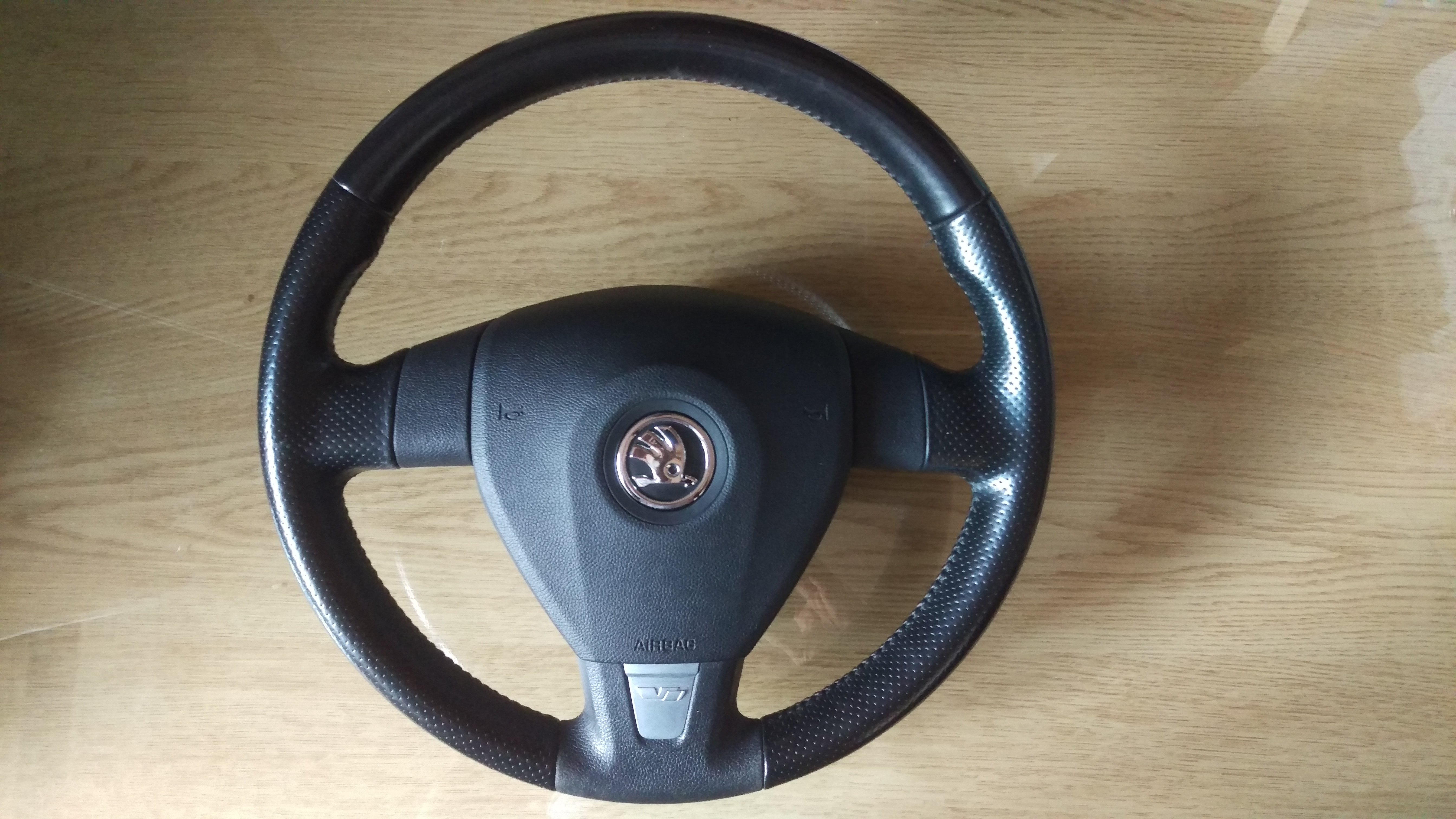

Hi,
I want to replace my VRS old style steering wheel badge with the new style. Some people seem to be a bit over the top warning that the air bag might go off. But one can hit the wheel centre when pressing the horn and the airbag doesn not deploy accidentally. I have not heard of any cases where the airbag has deployed when playing with the badge. It is strange that my car has new style badges in all other places except the steering wheel.

8 hours ago, OctaviaVRS2 said:
You mention a tool called a from removal tool. That sounds very strange.
Yeah, it was a typo :) I used some plastic trim (from) removal tools to remove the front/back badges.
As for the steering wheel badge, that's not something that's easy to remove given It's designed to stay attached through the explosive deployment of an airbag...
I'm not a fan of trying to remove the existing logo and trying to attach a new one securely, so a few other options include:
- a thin vinyl sticker over the original (probably doesn't look the best but shouldn't cause much damage in a crash/airbag deployment)
- replacing the entire airbag cover (only works for the FL MK2, care is needed and I can't remember where to buy from)
- replacing the steering wheel and airbag with a MK3 style (most expensive)
Plenty more discussion here: https://www.briskoda.net/forums/topic/354511-steering-wheel-badge/
I went for option three when I did mine:
Looks very smart mate
